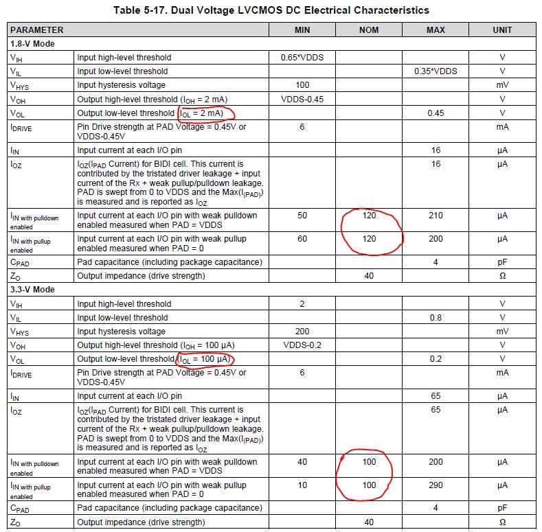

We are analyzing the state of the processor's pins after reset.
In which cases do I need to use an external pull-up or pull-down resistor on the GPIO input signal?
What is the specific resistance value inside the GPIO pin of the processor?
What are the typical and maximum current requirements for GPIO?
Thanks.

    1.  You can find buffer types, pullup capability, and default mux mode of each pin in the Datasheet, Table 4.1 Ball Characteristics.
    2.  It is completely dependent on your use-case. Depends on the buffer type of the external device (push-pull, open-drain) and if this device always drives 0 or 1 (e.g. will it sleep sometimes and go tri-state, or, disconnects via a PCB connector). Depends if it drives relatively static signals: 0 to few kHz, or faster.
    In other words:
    - if you expect that external driver is always online and it is a push-pull, you can disable the internal pullup to save some power.
    - If external device goes tri-state or disconnect - enable an internal pullup  - in most cases should be enough
    - If your external device is some interface (for ex,. I2C, SPI) you need  pullups depending on the interface needs
    3. Please check the datasheet for the internal resistance. Very roughly it is somewhere 40-70 kohms.
    4. Sorry, I don't understand you question for current requirements
    Stan
  • Hi Stan,
    Thank you very much for your reply, I am already clear.
    Two other questions:
    Q1: What is the difference between IOL and IIN? Does IIN refer to the injection current of PIN in tri-state?
    Q2: If the GPIO output is low, why is the driving capability of the 1.8V mode larger than 3.3V, is this normal?
  • Q1: Note that IOL=2mA  (Output current during drive Low) is only a condition to parameter VOL.
    Yes, IIN should be the max leakаge current with pullups/downs disabled.
    Q2: Driver strength is defined as nominal value of 40-Ohm in all conditions. This, however, this will result in different values for the current in 3.3V and 1.8V modes. ~8mA and 4.5mA respectively. Note that min and max driver strength wasn't defined and may vary.
