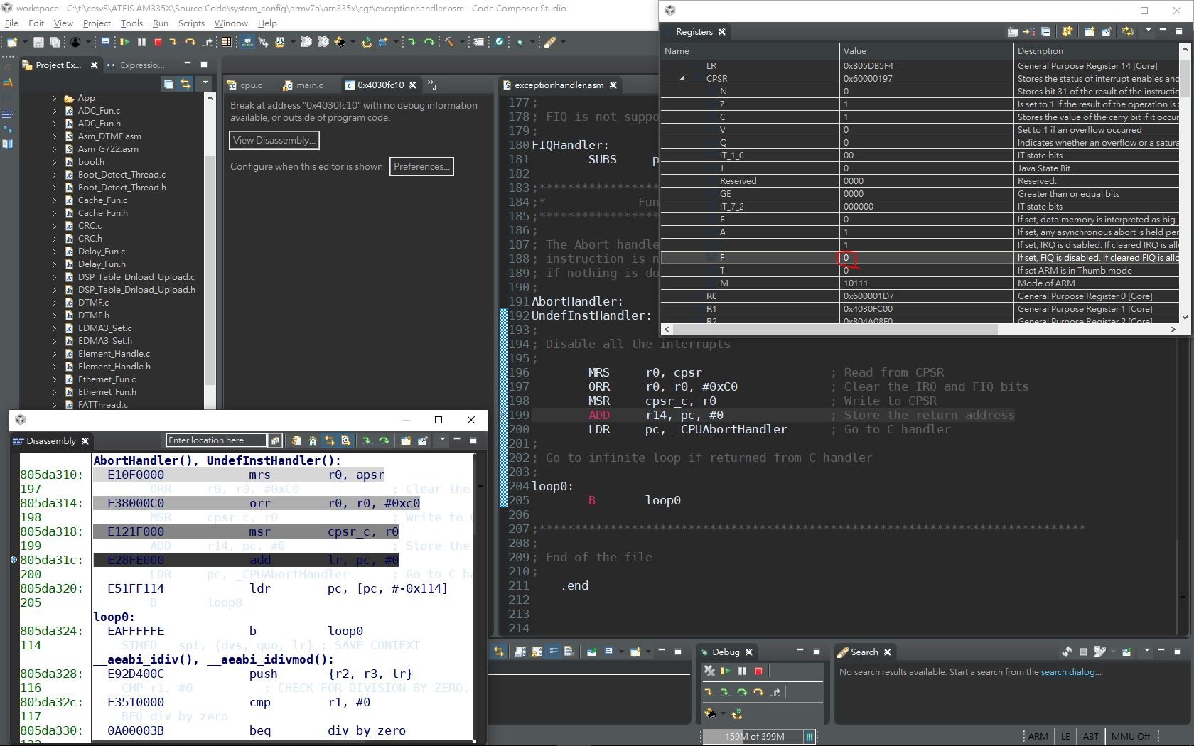

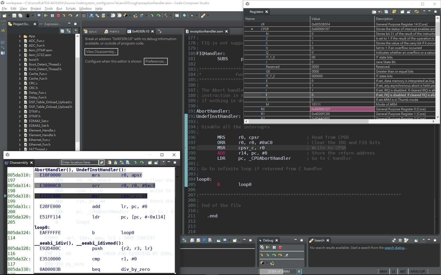

When program reached at line 199, that is to say, the program already executed line 198.
The F bit in CPSR will not be changed.
