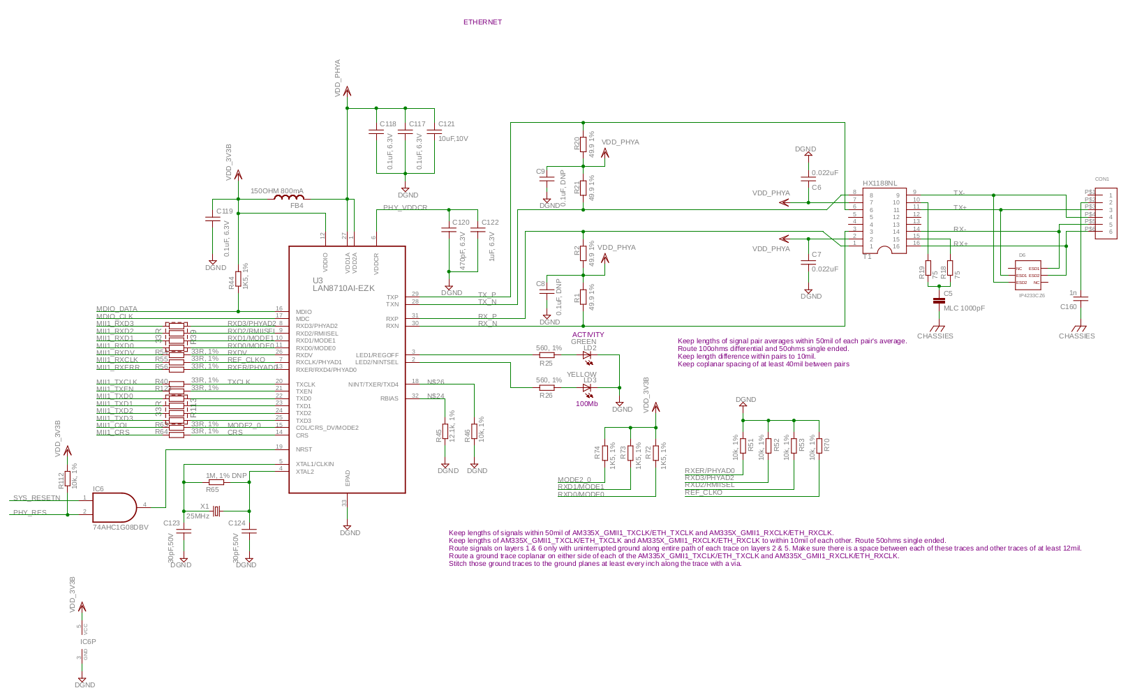

Board does not get dhcp lease when running 100 MBit/s. Mii-registers reports link is up and auto neg is done. Wireshark shows no data.
When switching to 10 Mbit full duplex and autoneg on the board connectes and gets a dhcp lease after a while. Can verify with wireshark.
We also have one board from the production batch that actually goes up in 100 MBit/s and gets a dhcp lease but on that one 10 Mbit does not work.
We have tested to increase the time the PHY is in reset (normally around 29-33 ms) to 1 sec and still no improvement. This lead us to believe that there is a layout issue, is this something we can get help with if we send design-files?
Board:
We have implemented a am3358 together with a LAN8710AI PHY on a custom board (similar to the beaglebone black), connected using MII. We have an earlier version that works fine,
now we have a somewhat changed board version (powersupply added to driveboard) that somehow is not working.
Compiler and OS:
We use the Linux ti-4.14.40-rt29-gd5443cbd3b ḱernel and gcc with arago toolchain (arm-linux-gnueabihf). The OS is ubuntu 12.04 core with some stuff picked from the TI-sdk.

Any ideas where to start look for the problem?
This is the scheme for the PHY:
    Looking at the ethtool statistics it looks like the MAC interface is receiving packets with no errors. You are reporting that no TX packets are being detected by wireshark. The ethtool statistics indicate that the packets are leaving the interface so to me that means the TX path to the link partner needs to be verified.  You might try directly connecting with the machine that is running wireshark and use static IP addresses, this would give you access to the hardware statistics of the link partner so you could check it's RX error counters or even receive packet counters to see if the packets are actually reaching the link partner.
    While this a board re-design you may want to re-do timing analysis between the MAC and PHY to make sure both RX and TX paths still meet timing expectations.  If you have not seen this document from TI please review High-Speed Interface Layout Guidelines:
    Spraar7
    Please note that TI does not provide board layout review.
    Schuyler
    Thanks for the input, I really appreciate it. I will come back with the results and how we solve this.
    Mattias
  • We found the solution.
    When we were differential probing TX +/- the 100 Mbit/s started working. So we figured it was a cap equal to the connected probes we needed between +/-. This also worked, we placed a cap between tx_n and tx_p with the size 68pF, and it worked in 100 Mbit.
    Why?
    Well, we measured the Vout voltage using the diffprobes and found that it is ~2,5 V, this should be ~1 V when running 100 Mbit. When we added the cap we probably lowered the potential between the lines enough so that it worked.
    Why is the voltage high?
    After more measuring we found that the resistors placed between tx_n and tx_p and vdd_phya (R20 and R21), that's supposed to be 49.9 Ohm was actually 49.9 kOhm. This was the error.
    When the resistors where switched to 49,9 ohm 100 Mbit is working.
    Now we need to do some more measurement to be sure, does anybody know how to generate a MLT-3 test signal from the Sitara+LAN8710?
    Cheers /Mattias
