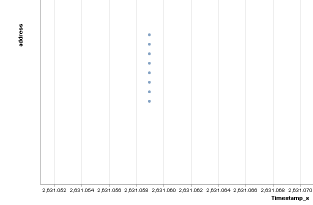

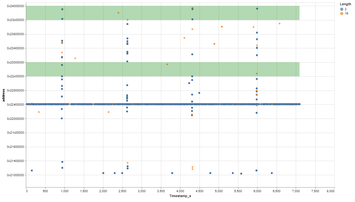

We are troubleshooting an issue that involves unidentified PCIe transactions that originate from the am5728.
What makes these transactions stand apart from the normal traffic we recognize, is the transaction length and the target address.
1) The target address is typically an invalid address with respect to our custom hardware.  This causes timeouts and other issues to occur.
2) The transaction length is either 16 DW or 2 DW reads and appear as 1 x 16 DW or 8 x 2 DW
Example transactions are pasted below.
We suspect these transactions may be associated with caching, but have verified that caching is disabled on this space.  Are there other blocks in the am5728 that generate transactions with these characteristics?
Is the "firewall" in the L3 interconnect something we could use to protect this space and get a clue about the originator?
We have attempted to use the MMU to protect this space, but the unidentified transactions still occur with no seg faults.  Intentionally accessing the invalid addresses in this region confirms the MMU protection does cause seg faults.  This result seems to point away from our software application having a bad pointer or something.
Our kernel driver does not need to access this space, so we disabled the code that iomaps the BAR4 region associated with the addresses below.  We think this rules out a bad pointer in the driver.
We have also injected purposeful PCIe transactions with known payload to check for correlation between application code, driver ISR, driver ioctl, etc. and the unidentified transactions do not appear to correlate with the software we have instrumented.
Are there any tools, techniques or clues we can use to identify the originator of these transactions?
1 x 16 DW:
Timestamp
Link
Payload
Address[31:0]
PacketType
STP_SeqNum
Fmt
Length
'517.255 858 us'
SA 1_Dn
0x23A0B3E4
MRd(32)
0x07AE
0x0
1
'518.934 962 us'
SA 1_Up
0008 0053
CplD
0x0B71
0x2
1
'519.535 579 us'
SA 1_Dn
0000 0002
0x23A0B3E4
MWr(32)
0x07AF
0x2
1
'523.707 103 us'
SA 1_Dn
0x23A0C3E4
MRd(32)
0x07B0
0x0
1
'525.388 081 us'
SA 1_Up
0008 0000
CplD
0x0B72
0x2
1
'525.980 265 us'
SA 1_Dn
0000 0002
0x23A0C3E4
MWr(32)
0x07B1
0x2
1
'548.397 053 us'
SA 1_Dn
0x23A010D0
MRd(32)
0x07B2
0x0
1
'550.066 787 us'
SA 1_Up
0000 0000
CplD
0x0B73
0x2
1
'550.786 403 us'
SA 1_Dn
0000 0000
0x23A010D0
MWr(32)
0x07B3
0x2
1
'6.041 890 314 ms'
SA 1_Dn
0x22ED1640
MRd(32)
0x07B4
0x0
16
'6.085 532 026 ms'
SA 1_Up
0000 0000 0000 0000 0000 0000 0000 0000 0000 0000 0000 0000 0000 0006 0000 0000 0000 0000 0000 0000 FFFF FFFF 0000 0000 FFFF FFFF 0000 0000 0000 0000 0000 0000
CplD
0x0B74
0x2
16
'72.100 189 796 ms'
SA 1_Dn
0x22A26014
MRd(32)
0x07B5
0x0
1
'72.101 878 270 ms'
SA 1_Up
0000 0000
CplD
0x0B75
0x2
1
'72.103 840 348 ms'
SA 1_Dn
00DF FFFF
0x22A26014
MWr(32)
0x07B6
0x2
1
'72.107 631 450 ms'
SA 1_Dn
0x23A26014
MRd(32)
0x07B7
0x0
1
'72.109 325 546 ms'
SA 1_Up
0000 0000
CplD
0x0B76
0x2
1
'72.109 981 446 ms'
SA 1_Dn
00DF FFFF
0x23A26014
MWr(32)
0x07B8
0x2
1
'72.118 503 461 ms'
SA 1_Dn
0x22A26044
MRd(32)
0x07B9
0x0
1
'72.120 211 612 ms'
SA 1_Up
0000 0000
CplD
0x0B77
0x2
1
'72.120 878 756 ms'
SA 1_Dn
00DF FFFF
0x22A26044
MWr(32)
0x07BA
0x2
1
'72.123 342 129 ms'
SA 1_Dn
0x23A26044
MRd(32)
0x07BB
0x0
1
8 x 2 DW:
Timestamp
Link
Payload
Address[31:0]
PacketType
STP_SeqNum
Fmt
Length
'47.429 512 949 ms'
SA 1_Dn
0000 0100
0x23A053E4
MWr(32)
0x0924
0x2
1
'47.430 232 565 ms'
SA 1_Dn
0x23A053E0
MRd(32)
0x0925
0x0
1
'47.431 940 716 ms'
SA 1_Up
0000 0001
CplD
0x0F21
0x2
1
'47.432 901 141 ms'
SA 1_Dn
0x23A053E4
MRd(32)
0x0926
0x0
1
'47.434 607 418 ms'
SA 1_Up
0000 0003
CplD
0x0F22
0x2
1
'47.436 982 713 ms'
SA 1_Dn
0x23A053E4
MRd(32)
0x0927
0x0
1
'47.438 653 384 ms'
SA 1_Up
0000 0003
CplD
0x0F23
0x2
1
'47.439 301 788 ms'
SA 1_Dn
0000 0200
0x23A053E4
MWr(32)
0x0928
0x2
1
'47.440 001 727 ms'
SA 1_Dn
0x23A053E0
MRd(32)
0x0929
0x0
1
'47.441 702 382 ms'
SA 1_Up
0000 0001
CplD
0x0F24
0x2
1
'67.402 187 047 ms'
SA 1_Dn
0x22ED54D0
MRd(32)
0x092A
0x0
2
'67.402 203 913 ms'
SA 1_Dn
0x22ED54D8
MRd(32)
0x092B
0x0
2
'67.402 228 275 ms'
SA 1_Dn
0x22ED54E0
MRd(32)
0x092C
0x0
2
'67.402 245 141 ms'
SA 1_Dn
0x22ED54E8
MRd(32)
0x092D
0x0
2
'67.402 269 503 ms'
SA 1_Dn
0x22ED54F0
MRd(32)
0x092E
0x0
2
'67.402 286 369 ms'
SA 1_Dn
0x22ED54F8
MRd(32)
0x092F
0x0
2
'67.402 306 983 ms'
SA 1_Dn
0x22ED54C0
MRd(32)
0x0930
0x0
2
'67.402 327 597 ms'
SA 1_Dn
0x22ED54C8
MRd(32)
0x0931
0x0
2
'67.445 874 672 ms'
SA 1_Up
0000 0000 0000 0000
CplD
0x0F25
0x2
2
'67.488 474 440 ms'
SA 1_Up
0000 0000 0000 0000
CplD
0x0F26
0x2
2
'67.531 137 924 ms'
SA 1_Up
0000 0000 0000 0000
CplD
0x0F27
0x2
2
'67.573 802 345 ms'
SA 1_Up
0000 0000 0000 0000
CplD
0x0F28
0x2
2
'67.616 435 845 ms'
SA 1_Up
0000 0000 0000 0000
CplD
0x0F29
0x2
2
'67.659 099 329 ms'
SA 1_Up
0000 0000 0000 0000
CplD
0x0F2A
0x2
2
'67.701 729 081 ms'
SA 1_Up
0000 0000 0000 0000
CplD
0x0F2B
0x2
2
'67.744 434 730 ms'
SA 1_Up
0000 0000 0000 0000
CplD
0x0F2C
0x2
2
'77.187 984 545 ms'
SA 1_Dn
0x22A26014
MRd(32)
0x0932
0x0
1
'77.189 687 074 ms'
SA 1_Up
0000 0000
CplD
0x0F2D
0x2
1
'77.191 280 911 ms'
SA 1_Dn
00DF FFFF
0x22A26014
MWr(32)
0x0933
0x2
1
'77.195 169 461 ms'
SA 1_Dn
0x23A26014
MRd(32)
0x0934
0x0
1
'77.196 879 486 ms'
SA 1_Up
0000 0000
CplD
0x0F2E
0x2
1
'77.197 496 032 ms'
SA 1_Dn
00DF FFFF
0x23A26014
MWr(32)
0x0935
0x2
1
'77.204 953 615 ms'
SA 1_Dn
0x22A26044
MRd(32)
0x0936
0x0
1
'77.206 607 420 ms'
SA 1_Up
0000 0000
CplD
0x0F2F
0x2
1
'77.207 280 186 ms'
SA 1_Dn
00DF FFFF
0x22A26044
MWr(32)
0x0937
0x2
1
'77.209 571 151 ms'
SA 1_Dn
0x23A26044
MRd(32)
0x0938
0x0
1
'77.211 264 310 ms'
SA 1_Up
0000 0000
CplD
0x0F30
0x2
1
'77.211 864 927 ms'
SA 1_Dn
00DF FFFF
0x23A26044
MWr(32)
0x0939
0x2
1

  • Thank you, Rex.
    I have a couple of charts to share that might help with brainstorming about where the transactions where coming from. These are the “before” charts, but I am not including a chart post workaround, because it would blank!
    The horizontal axis is in seconds, so the timespan represented below is about 16 hours. The vertical axis is the target address of the transactions. Blue transactions are 8x2DW and orange transactions are 1x16 DW. The green bands are regions of our custom hardware that are known to be disrupted by these transactions.
    Some patterns to note are 1) the concentration just below 0x23000000 move to other locations on reboot, 2) the transactions away from the concentrated location cluster in vertical stripes that are uniformly separated, 3) there are no transactions outside of the regions associated with BARs of our device (see lspci output above).
    Below is a different test run over about 2 hours, following a reboot. Notice that the concentration moved from near 0x23000000 to nearby 0x22400000. This shift appears to be random between reboots. The most puzzling thing is the consistently spaced vertical stripes, which exist in the previous chart, but were not obvious on first glance.
    The best idea I have to narrow down the originator of these transactions is to revert the workaround and instrument the TLB miss handler in the kernel. I think we could log the program counter value from the TLB miss exception when the physical page number matches the green locations above. Maybe the log data could be written to mailbox locations that we capture with the PCIe bus analyzer.  Since the workaround manipulates the Linux page tables, it seems plausible this TLB miss experiment would turn up a clue.
    With a workaround in hand, it may be some time before this next experiment is conducted. Thank you for continuing to think on an explanation.
  • Hi, Shane,
    Interesting diagrams. Does each blue dot stand for a 8x2 DW read or just a single 2DW read and should group 8 of them as one transaction?
    If it is 8x2DW read, it will mean in that sec, there are multiple transactions spread out accessing to different addresses.
    I have involved our silicon IP engineer and PCIe developer in the discussion. After seeing this diagram, I am thinking to involve our ARM expert to see if he has some insight to this or anything may be cache line related.
    I'll send the diagrams for internal discussion. Thanks for the info.

  • Hi, Shane,
    I read your description again. The blue dot is 8x2DW transaction(period).
    Rex
  • Yes, if we zoom in on the blue dots we see groups of eight:
