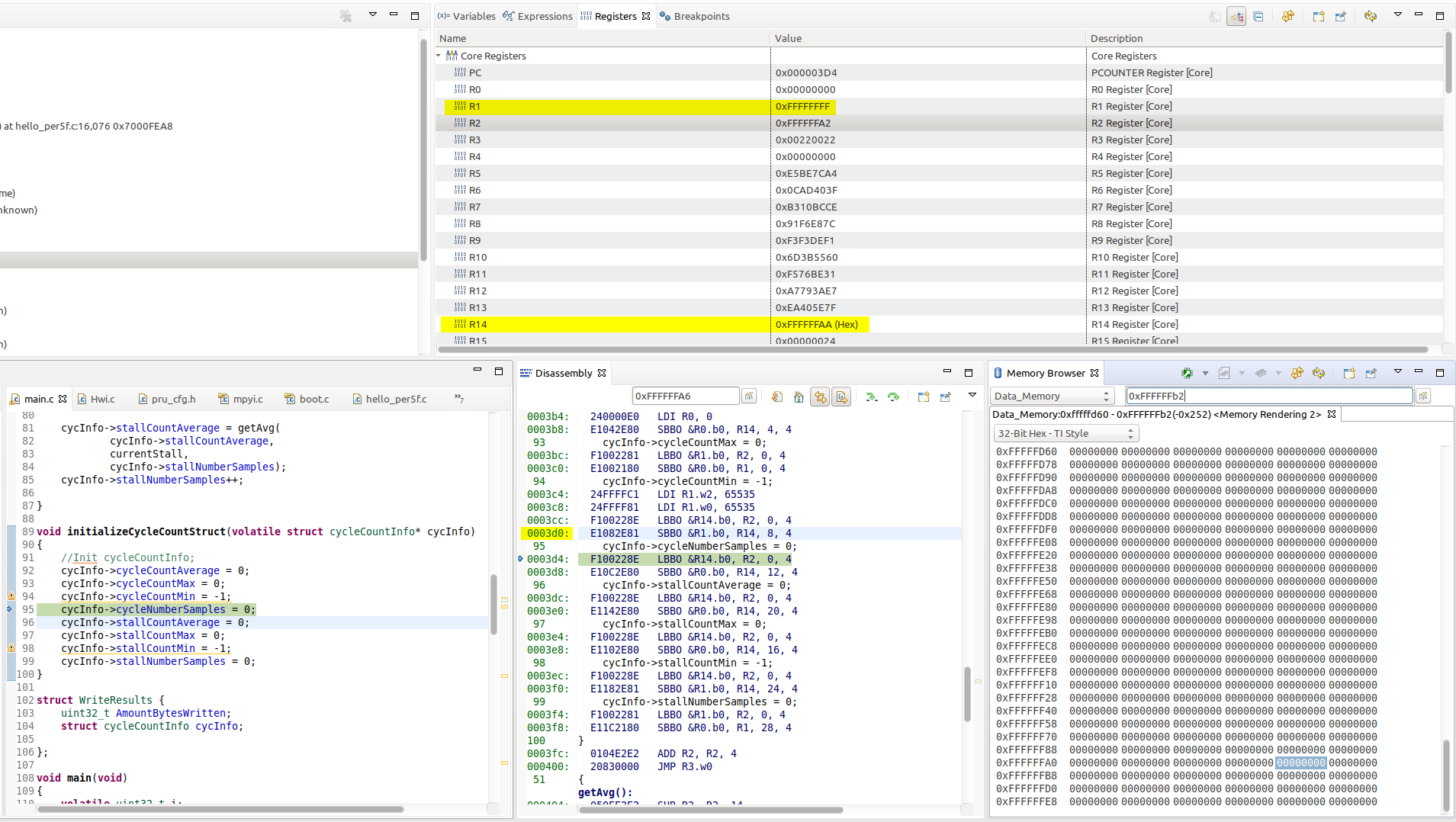

I have to debug a PRU program which runs on AM6548. To understand exactly what happens I try to follow the assembler code. But at a certain SBBO instruction, I can't see the change/new value in memory.
C Code Line 94. Instruction 0x3d0 got executed at last step.
I think the PRU should copy 4 Bytes starting from register R1.b0 to address which is stored in R14 plus offset of 8. Is this correct?
If yes, I should see at memory address 0xFFFFFFAA + 0x8 the value 0xFFFFFFFF. I am wondering about the high address, according my linker script only PRU_DMEM_0_1 is used, which starts at address 0x0 and is 4kB big.
I'm sure I miss a simple mistake...
