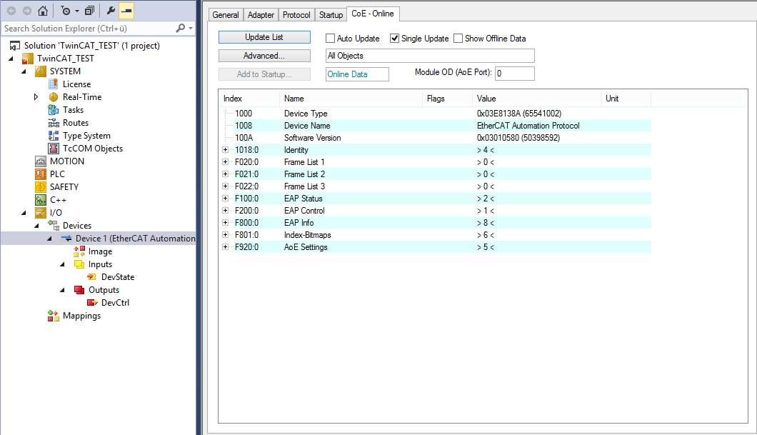

Than I tried ethercat_slave_full_AM437x_arm, it compile without errors, I loaded it on the device and run the application, but when I use TwinCAT (v. 3) It would recognize the device without see the Box to toggle LEDS.
The device in the latter case remains in INIT state, while in the demo application runs in OP state.

    >>If you manually change the device from 'INIT' to 'OP' in TwinCAT, what would happen?
    I cannot change the state because I don't have that option on TwinCAT:
    Moreover I have done some test on the code and I know that it runs the "LEDtask" and the "APPL_Application(void)" at least one.
