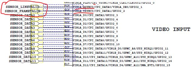

    But where do you check the captured frames? Do you dump them from the memory and verify them offline? or they are going to the display..
    Also how many data valid lines connected to the VIP? if it is 12bits, then VIP will store 12bit data in 16bit container, where upper 4bits (or lower 4bits, depending on which output format is used in VIP) are set to 0.
    Please note that display does not support RAW16 data format.. This needs to be converted into YUV or RGB format..

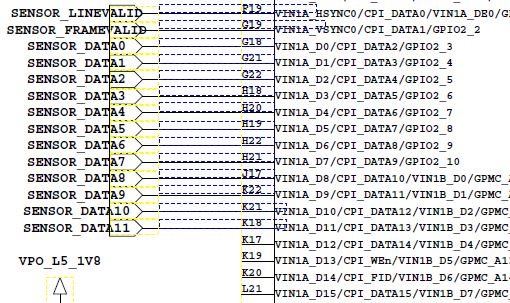

    They connected only D0 ~ D11 in below.
    They build their usecase using usecase gen and their usecase is capture link -> algorithm link -> display link.
    in algorithm link, they modified 'color to gray' function we provided.
    When they set 'SYSTEM_DF_YUV422' and 8bit,  they found it works well and they also found algorithm link was called.
    But, when they changed parameters to 'SYSTEM_DF_RAW16'  and 16bit in above, it seemed the algorithm link was not called and they could not find any logs in the algorithm link.

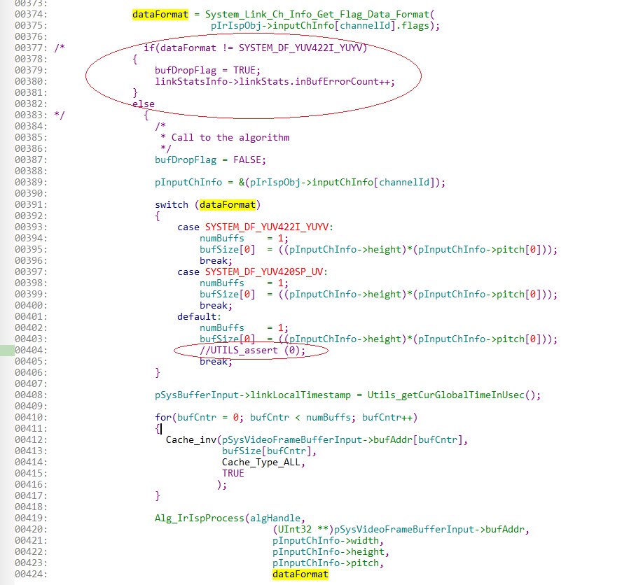

  • Hi SI,
    Please note that there is a check in the ColorsToGrey algo link also does not support RAW16 bit format. There is a check in the link, which allows processing only for YUV422 and YUV420 formats.. This check is present in the AlgorithmLink_ColorToGrayProcess API.. It just asserts if the input data format is not YUV422 or YUV420. You would have to change it to support RAW 16bit input format..
    Rgds,
    Brijesh

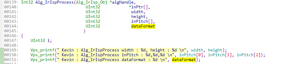

    Could you please let me know the condition which colorToGrayLink is called?
    e.g. is it called along with pInprms->dataFormat or pOutprms->dataFormat or else?
    They changed it as below.
    and they inserted printf() in the Alg_IrIspProcess() function as below.
    But, they could not find any printf() string when he changed parameters.
    pInstPrm->videoIfWidth = SYSTEM_VIFW_16BIT
    pInprms->dataFormat = SYSTEM_DF_RAW16
    pInprms->dataFormat = SYSTEM_DF_RGB16_565

    [DSP1  ]     18.926401 s:  SYSTEM: Heap = LOCAL_DDR            @ 0x00000000, Total size = 524288 B (512 KB), Free size = 521552 B (509 KB)
    But, with below parameters, they can find printf() string and output image.
    pInprms->dataFormat = SYSTEM_DF_YUV422P
    pInprms->dataFormat =SYSTEM_DF_YUV420SP_UV
    [IPU1-0]     16.541389 s:  KEVIN: Fvid2_start
    [DSP1  ]     16.243549 s:  IPC_IN_0   : Create in progress !!!
    [DSP1  ]     16.244067 s:  IPC_IN_0   : Create Done !!!
    [DSP1  ]     16.244250 s:  ALGORITHM: Create in progress (algId = 39) !!!
    [DSP1  ]     16.244372 s:  ALGORITHM: Create Done (algId = 39) !!!
    [DSP1  ]     16.244555 s:  IPC_OUT_0   : Create in progress !!!
    [DSP1  ]     16.244647 s:  IPC_OUT_0   : Create Done !!!
    [DSP1  ]     16.517690 s:  SYSTEM: SW Message Box Msg Pool, Free Msg Count = 1023
    [DSP1  ]     16.517751 s:  SYSTEM: Heap = LOCAL_L2             @ 0x00800000, Total size = 227264 B (221 KB), Free size = 227264 B (221 KB)
    [DSP1  ]     16.517812 s:  SYSTEM: Heap = LOCAL_DDR            @ 0x00000000, Total size = 524288 B (512 KB), Free size = 521552 B (509 KB)
    [DSP1  ]     16.540840 s:  Kevin : Alg_IrIspProcess width : 320, height : 240
    [DSP1  ]     16.540901 s:  Kevin : Alg_IrIspProcess inPitch : 320,320,0
    [DSP1  ]     16.540932 s:  Kevin :
    Alg_IrIspProcess dataFormat : 7

  • Hi SI,
    Lets first check if the capture itself is working. This API will not get called if the capture is not forwarding buffers..
    Can you please press 'p' on the console and check if capture is working at correct fps? If possible, please share the statistics..
    Rgds,
    Brijesh
  • Brijesh,
    I agree with you.
    Do you mean the statistics is the console output when press 'p', right?
    And could you please let me know which dataformat among input and output will be used in colorToGrayLink?
    As I said in above log,
    When my customer input below parameters,
    pOutprms->dataFormat =SYSTEM_DF_YUV420SP_UV(7)
    They found 'pOutprms->dataFormat' value was printed in the Alg_IrIspProcess() function as below.
    [DSP1 ] 16.540932 s: Kevin : Alg_IrIspProcess dataFormat : 7
    Thanks and Best Regards,
    SI.
  • Hi SI,
    Yes, when we press 'p', it prints link stats on UART console.
    ColorsToGrey was just supporting YUV422/YUV420 to Luma output.
    Now for you, since it is working for YUV420, i think there is some issue in capturing RAW16 data..
    Rgds,
    Brijesh

    Their sensor was connected to VIP over discrete sync interface. I attached their HW schematic in below.
    Their sensor output is grey - e.g. Y(lumar) only.
    SI.

  • Hi SI,
    ok the connection looks correct. Can you please also check the pinmux is set correctly for these pins? These pins have many other functions, without pinmux set correctly, VIP will not be able to detect the input frame correctly.
    Rgds,
    Brijesh
  • Hi Brijesh,
    OK in the table means I can capture the image from luma sensor, but I'm not sure if the captured image is correct.
    You mean if I set SYSTEM_DF_YUV422P as input format and SYSTEM_DF_YUV422I_UYVY as output format then I can get correct data from sensor without any changing data, right?
    Because the format of inPtr[] coming to the algorithm process function is the same with the output format (pOutprms->dataFormat) that I changed in the above,
    I can guess that somewhere in the source code changes the buffer format from pInprms->dataFormat to pOutprms->dataFormat. Am I right?
