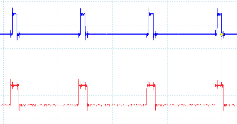

Hi am using CSL library to generate PWM pulse of high frequency. Am using PWM3 for this and able to generate pulses of required frequency and duty cycle. But not able to create 180 phase shift between two pulses(EPWM3A & EPWM3B). Also able to create deadband between two pulses

    The UP-DOWN count mode can be used to create 180 phase shift between EPWM3A & EPWM3B.  For example, you can use CNT = ZERO to trigger EPWMxA high and then CNT = PRD to trigger EPWMxB high.  The CMPA and CMPB can then be used to set the EPWMxA and EPWMxB pulse width.  (Note in order to preserve your desired frequency, EPWM_TBPRD should be set at half of your desired period.)

  • Hi Melissa,
    My use case is to create a sine wave using two 180 degree phase shifted PWM pulses whose frequency and duty cycle can be varied. Duty cycle variation is in between 0 to 50 degrees and frequency approx 500KHz.
    Am able to control these two parameters and also able to control EPWM3A as per requirement, but not able to create EPWM3B which is same as EPWM3A just it is 180 phase shift to EPWM3A.
    I tried with deadband, UP-Down Configuration.
    Also tried with UP-Count with event enable to control EPWMB
    Can you please tell be setting of ACTION QUALIFIER module in both the cases.

    Below is a suggested configuration to achieve your desired phase shift:
    EPWM_TBCTL [CTRMODE] = Up-down-count mode
    EPWM_TBPRD [TBPRD] = Half of desired period/freq
    EPWM_CMPA = Whatever value you’re currently using
    EPWM_CMPB = (TBPRD – CMPA)
    EPWM_AQCTLA [ZRO] = Set (Force EPWMxA output high)
    EPWM_AQCTLA [CAU] = Clear (Force EPWMxA output low)
    EPWM_AQCTLB [PRD] = Set (Force EPWMxB output high)
    EPWM_AQCTLB [CBD] = Clear (Force EPWMxB output low)
    Melissa
  • Hi Melissa,
     Thanks this resolve my query completely its work
