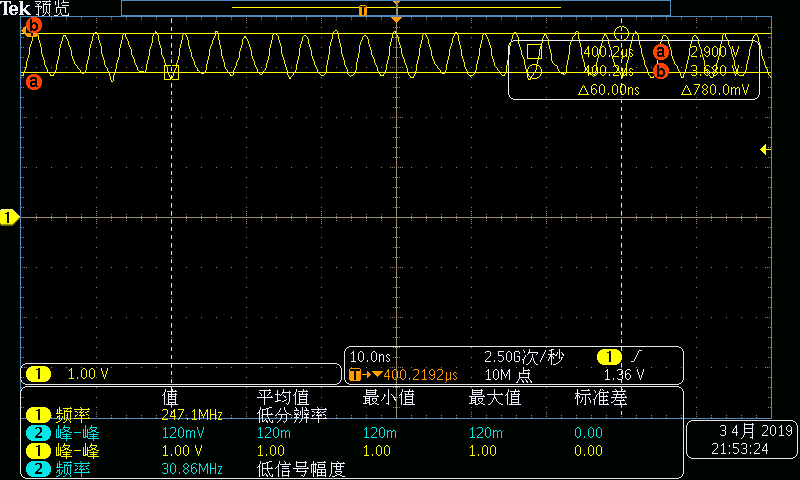

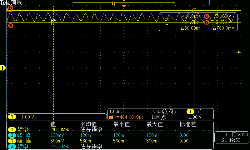

finally we designed a AM3358 board with a AR8031 and a AR8035(AR8031 run in 1000M mode/AR8035 run in 100M mode) with own software, the shematic of AR8031 and the RGMII interfaces pinmux is exactly the same to TMDSSK3358
  • the both eth1(AR8031/1000M) and eth0(AR8035/100M) of self-dev AM3358 board can be link up/down normally
  • when I set eth1 at 1000M mode, ping with 65000 byte data length(pattern 0X00) is OK
  • when I set eth1 at 1000M mode, ping with 65000 byte data length(pattern 0XF0)  the probability of time out is about(95%), then I find that when I ping with patern 0XF0 and the data length is >700 bytes, the ping test is most likely  failed
  • when I set eth1 at 100M mode, it works good at any ping test conditions
fig 1
fig 2
  • I'm curious why self-dev board ping with pattern 0XF0 data length>700 is alway failed and why there exists a 250MHz signal? Could you give me some advise?
