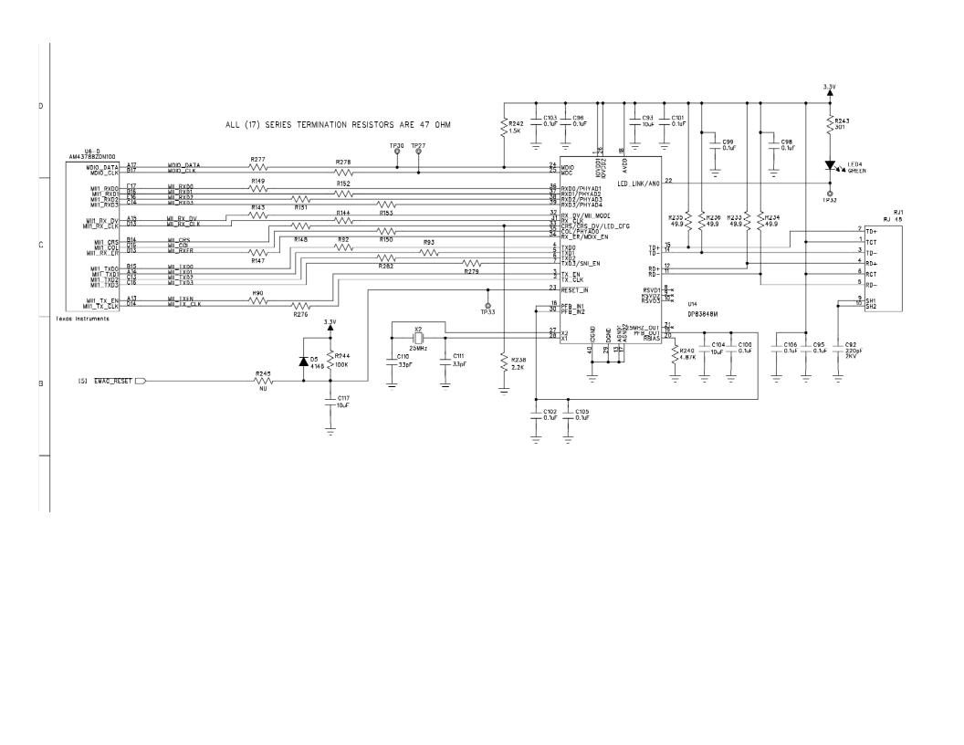

the pinmux for mii1 is:
static struct module_pin_mux mii1_pin_mux[] = {
{OFFSET(mii1_txen), MODE(0)}, /* MII1_TCTL */
{OFFSET(mii1_rxdv), MODE(0) | RXACTIVE}, /* MII1_RCTL */
{OFFSET(mii1_txd3), MODE(0)}, /* MII1_TD3 */
{OFFSET(mii1_txd2), MODE(0)}, /* MII1_TD2 */
{OFFSET(mii1_txd1), MODE(0)}, /* MII1_TD1 */
{OFFSET(mii1_txd0), MODE(0)}, /* MII1_TD0 */
{OFFSET(mii1_txclk), MODE(0)}, /* MII1_TCLK */
{OFFSET(mii1_rxclk), MODE(0) | RXACTIVE}, /* MII1_RCLK */
{OFFSET(mii1_rxd3), MODE(0) | RXACTIVE}, /* MII1_RD3 */
{OFFSET(mii1_rxd2), MODE(0) | RXACTIVE}, /* MII1_RD2 */
{OFFSET(mii1_rxd1), MODE(0) | RXACTIVE}, /* MII1_RD1 */
{OFFSET(mii1_rxd0), MODE(0) | RXACTIVE}, /* MII1_RD0 */
{OFFSET(mii1_col), MODE(0) | RXACTIVE}, /* MII1_COL */
{OFFSET(mii1_crs), MODE(0) | RXACTIVE}, /* MII1_CRS */
{OFFSET(mii1_rxerr), MODE(0) | RXACTIVE}, /* MII1_RXERR */
{-1},
the ethernet setup in the board.c looks like:

when i wireshark the line there are no DHCP packets present
the PHY reset is high so it is not in reset
where else do i look to fix this?
  • so new day, new brain. i am starting to see some things that i didn't yesterday
    So we are trying to run in MII mode. our PHY is NOT a gigabit PHY, it is a DP83848M PHY
    i see that the pinmux options for these balls are GMII, RMII, and RGMII, but not MII
    so my question currently is: if we use this PHY in MII mode, are we guarantee'd to not be able to use ethernet?
    The AM437x parts only support MII so you should be to use the ethernet.
    Based on the console output the Ethernet link is being established but you are not seeing any packets come out on the interface, if my summary is correct. A quick review of the code looks like you are trying to use the second Ethernet interface on the board. Typically the TI boards use and only test the first port in u-boot. Is there a reason you are trying to use the second port? There maybe some significant code changes to implement using the second port in u-boot.

  • well we have the PHY connected to MII1 (which the EVM uses) and i didn't actively try to use anything but the default port.
    if you are talking about our PHY address our PHy chip should default to address 1 without any pullups/downs
    where in the code does it specify the port we are trying to use? according to the output we are trying to use port 0:
    "link up on port 0, speed 100, full duplex"
    in addition how should i set up for my board? should i set it up in the pinmux as RGMII but MII in the u-boot code or should i do it exactly like the EVM even though my phy doesn't support gigabit ethernet? does RGMII automatically scale down to normal MII?
    First I need apologize for the delay in responding.
    To answer your question, the pin mux needs to match between the PHY and the MAC, if your PHY is configured through HW strapping to be MII the MAC interface needs to be MII.
    Let's first double check that the PHY is seeing a link partner. Please do the following commands to output the state of link and the PHY:
    mii dump 1 0 - the one is PHY address 1
    mii dump 1 1
    Also please look at this register in the HW statistics block, we looking to see if the MAC thinks it sent packets.
    md.l 4a100934
    md.l 4a100938
    md.l 4a100964
    I will review the code a little bit more in the meantime.

    so looks like it isn't putting out anything

    Thank you for posting the stats location registers and the MII registers.
    I agree that the MAC is not output putting packets. The MII registers indicate that there is a link between the PHY and the link partner so the conditions appear correct for packets to be transmitted.
    The RTC crystal is only needed to clock the RTC IP in the SOC and to my knowledge should not be needed for the Ethernet interface. For the custom board DTS file that have been done, what other included DTSI files have been modified?

  • well part of my problem with doing it in linux is this:
    we have the ethernet PHY reset on a gpio line. in u-boot in board.c i take the PHY out of reset. when linux loads it appears to put the PHy back into reset. i only know this because 1) the PHY LED is off when the kernel loads and 2)the kernel can't find the PHY but u-boot can.
    i thought that if i took it out of reset in u-boot that the kernel wouldn't touch it but apparently it does. what can i do about this?
    Linux has a means to control the PHY reset line via a DTS property value for either the MDIO or MAC node. I want to confirm though that the PHY reset in the board design is intended to be handled via the network drivers, is that the case? The DTS binding docs for the mdio and MAC nodes cover this, but I will confirm after I hear back from you.
    Schuyler
  • our board designer connected a GPIO to the PHY reset. i don't have anywhere in the DTS file that tells the system that this is the reset line for the PHY since i don't know how to do that (what field exists? which module is it included in? i'm not an expert here). i am currently writing directly to the GPIO registers to handle the reset and that it working for u-boot but not for the kernel
    if you could fill me in on the DTS propertly value for the reset that would be great.
    i have tried phy_id = <&davinci_mdio>, <0>; and phy_id = <&davinci_mdio>, <1>; and it doesn't make a difference (assuming the <#> is the phy address)

  • so her's the update
    I added ti,no-reset-on-init; to the gpio bank that performed the PHY reset and i changed to phy_id = <&davinci_mdio>, <1>; and when linux boots i get an address and i have internet access. however when i do "dhcp" from u-boot i still get nothing but BOOTP. in addition when i do get to the kernel i cannot do DNS. every single time i have to give the command "udhcpc" and then i am able to access DNS. i got this trick from this post:
    https://e2e.ti.com/support/processors/f/791/t/640808?tisearch=e2e-quicksearch&keymatch=dns%20brad
    does u-boot just not work with my phy? it is because i am at phy address 1 and not 0?
    Using the ti, no-reset-on-init will work if the PHY is getting reset in U-Boot. It is important that the PHY is reset for certain amount of time. Are you exercising the reset line in U-Boot?
    The example I was thinking of would be found in arch/arm/boot/dts/am572x-idk.dts, this particular example is for the AM572x processors that are on the PRUs. In the pruss2_mdio node are two properties reset-gpios and reset-delay-us.
    To understand the first property you will need to look at the AM572x schematic to see the GPIOs selected to act as a reset to the PHY. Link to AM572x product page. The schematic is under the design files area.
    The second property refers to how the to how long of a reset pulse is needed. Please refer to Docmentation/devicetree/bindings/net/mdio.txt for details on these two properties.
    If you are able to get an address with an address of 1 for the PHY then this same address should work for U-Boot. The DHCP process should happen automatically too. Which file system are you using? The TI one? Could you attach the boot log?

  • i see:
    &pruss2_mdio {
    reset-gpios = <&gpio5 8 GPIO_ACTIVE_LOW>,
         <&gpio5 9 GPIO_ACTIVE_LOW>;
    reset-delay-us = <2>; /* PHY datasheet states 1uS min */
    following this example i was able to get linux to reset the phy, but u-boot did not take the phy out of reset (i removed my reset code from u-boot as i thought the addition of the reset code in the DTS file would do it for me). it would appear the dts file for the reset pin works in the kernel but nto u-boot

    Could you post a the snippet of the schematic that shows the EMAC with the PHY? In post the you mentioned that a GPIO reset line was added but I want to start at the beginning again debugging u-boot so we will review pin mux, phy addressing. The earlier mii tool dumps showed the PHY had auto-negotiated successfully with a link partner.
    This thread has gotten long as it has traveled from u-boot to Linux back to u-boot. The Linux portion proved the MAC /PHY interface is working so this can be claimed as a known good which means it should work in u-boot.
    Schuyler
  • yup, network works fine in the kernel.
    schematic:
