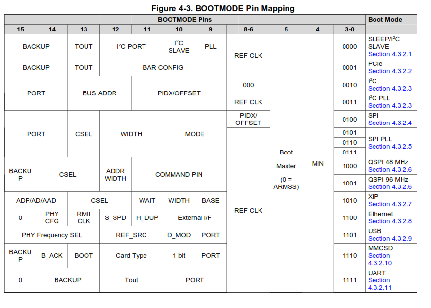

As mentioned in TRM  "section4.3.2 BOOTMODE Pins Description" and figure 4-3 , please elaborate BOOTMODE [4]  and BOOTMODE [5] .
As i want to boot my devce from SPI interface only.My first priority is to use minimum number of pins for boot configuration using QSPI interface FLASH.
THANKS
REGARDS JENS
    As I said in your other post, BOOTMODE[4] provides the flexibility to NOT connect all 16 bootmode pins.
    Each BOOTMODE provides this minimum configuration that will allow the device to boot in a particular bootmode. This minimum configuration is a combination of BOOTMODE[0-3] pins + some additional pins from BOOTMODE[15:4] for each boot mode.
    For QSPI boot you should see Section 4.3.2.6 QSPI Boot Device Configuration and Table Table 4-9. QSPI Mode Boot Configuration Field Description in the device TRM. I also notified the design team to elaborate if needed.

  • Hi Jens,
    Yordan is correct that the min bootmode pin allows you to select a boot mode with the minimum number of pins but that is a bit misleading. While bootmode[15:5] will be ignored, we still expect the customer to include pulling resistors on those pins.
    Regards, Bill
