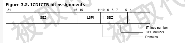

3.The value of IT lines number in the register ICDICTR reads 111,256 interrupt levels. Can this value be changed?

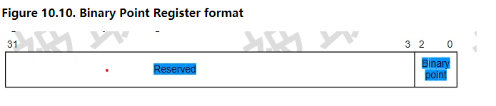

4.How to use the register ICCBPR?
else
        /* Non-Secure BPR */
        HW_WR_REG32((cpuIntfBaseAddr + GIC_CPU_ICCBPR),   -----INTC_NON_SECURE_MODE,The GIC_CPU_ICCBPR register is used but the GIC_CPU_ICCABPR is not
                       gicInst->gicConfig.nonSecureBinaryPoint);
