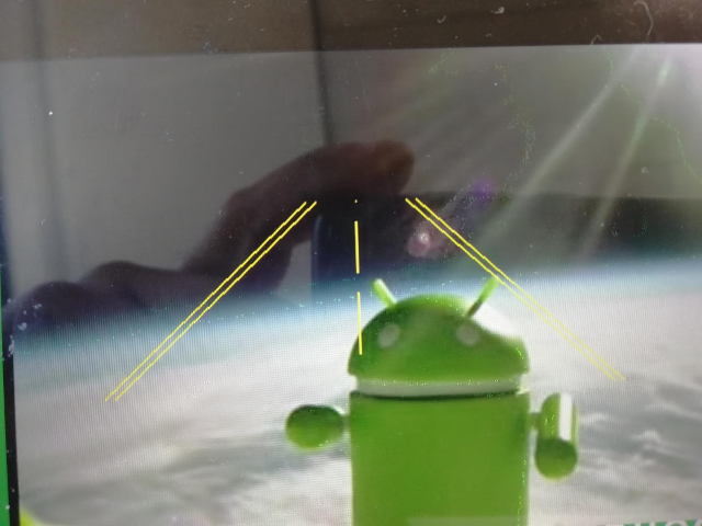

    An other question in the same topic, Please do you know how to paint guideliness for parking assistance ?Figure 5. Display Sharing Block Diagram on www.ti.com/.../spracb6.pdf
    Is it an other use case or the same for RVC ?

  • Hi Yordan,
    Thank you for your support,
    Now, I'm able to draw lines with Grpx DISPLAY_LINK_INST_DSS_VID2  and Video disp DISPLAY_LINK_INST_DSS_VID3.
    Could you please help me how to make Grpx transparent on Video disp (like steeting guidline) ?
    I try to use the same display_id but it doesn't work.
    Chokri
  • Hi Chokri,
    can you try to change globalAlpha to 0 for DISPLAY_LINK_INST_DSS_VID2 (also you may need to change Z order)
    Yordan
  • Hello Yordan,
    Thank you, It works fine only if I switch Grpx on VID3 and Display on VID2.
         pUcObj->Display_VideoPrm.rtParams.tarHeight = CAPTURE_DISPLAY_HEIGHT;
    -    pUcObj->Display_VideoPrm.displayId     = DISPLAY_LINK_INST_DSS_VID3;
    +    pUcObj->Display_VideoPrm.displayId     = DISPLAY_LINK_INST_DSS_VID2;
         pUcObj->Display_GrpxPrm.rtParams.tarWidth  = CAPTURE_DISPLAY_WIDTH;
         pUcObj->Display_GrpxPrm.rtParams.tarHeight = CAPTURE_DISPLAY_HEIGHT;
         pUcObj->Display_GrpxPrm.rtParams.posX      = VID2_POSX;
         pUcObj->Display_GrpxPrm.rtParams.posY      = VID2_POSY;
    -    pUcObj->Display_GrpxPrm.displayId          = DISPLAY_LINK_INST_DSS_VID2;
    +    pUcObj->Display_GrpxPrm.displayId          = DISPLAY_LINK_INST_DSS_VID3;
    Do you know if is possible to make it dynamic (move lines at runtime ) ?
