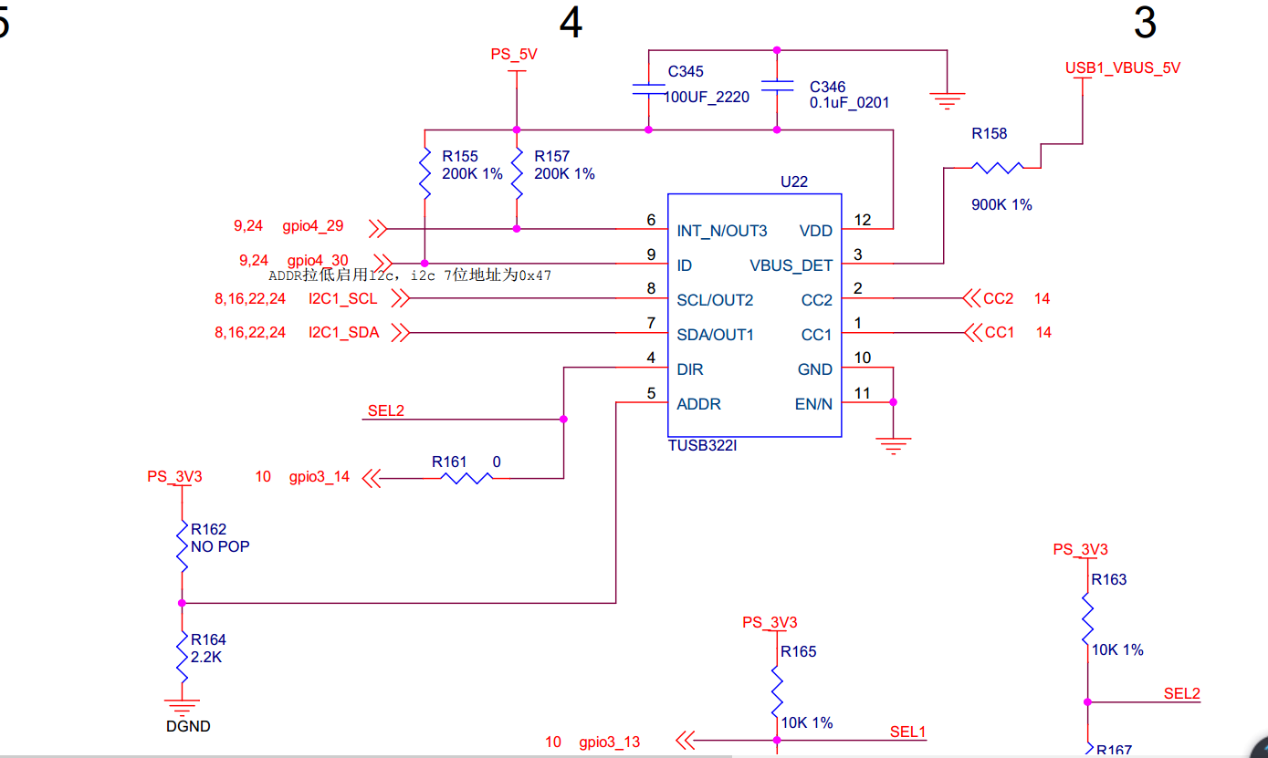

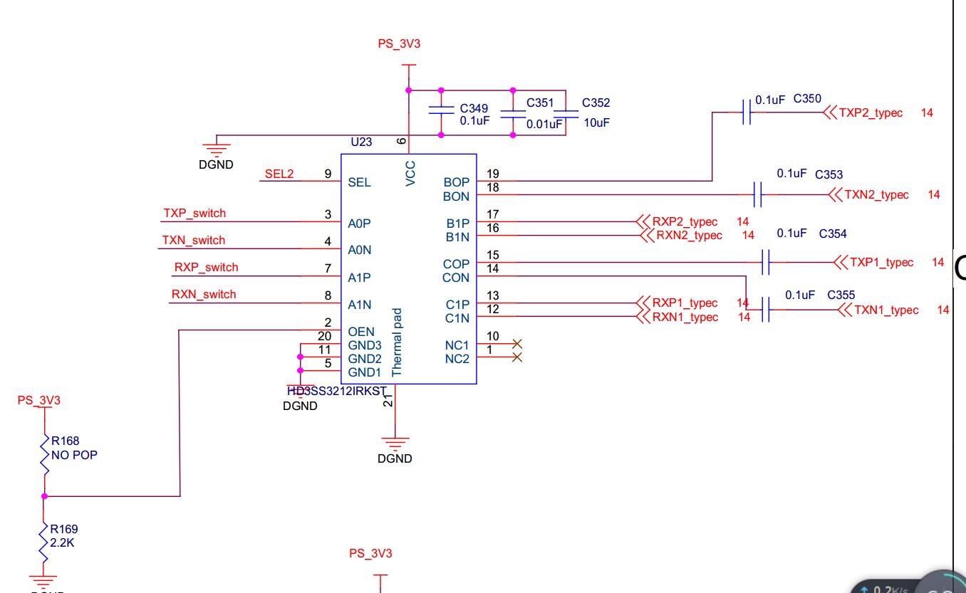

The following figure is about the typec and typeA signal selection.by  hd3ss3212:
The TUSB322I device implements Type-C Configuration Channel (CC) logic on the USB Type-C port.
Use the CC pin to determine port connection status and cable orientation, role detection, and Type-C current mode control.
I want to know if there is a driver and device tree file for the TUSB322I in the SDK?
