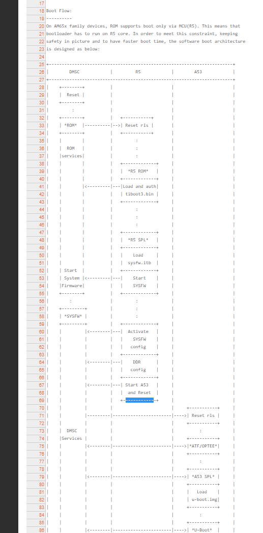

DRA80M: "DDR config" and "Start A53 and Reset" in boot flow
Part Number: DRA80M
Hi everyone,
According to the software boot architecture R5 core does "DDR config" and "Start A53 and Reset" steps (requests to system firmware).
Could you please point in the code where exactly each of those 2 steps (requests) are present?
Thank you in advance. Looking forward to hearing back from you.
