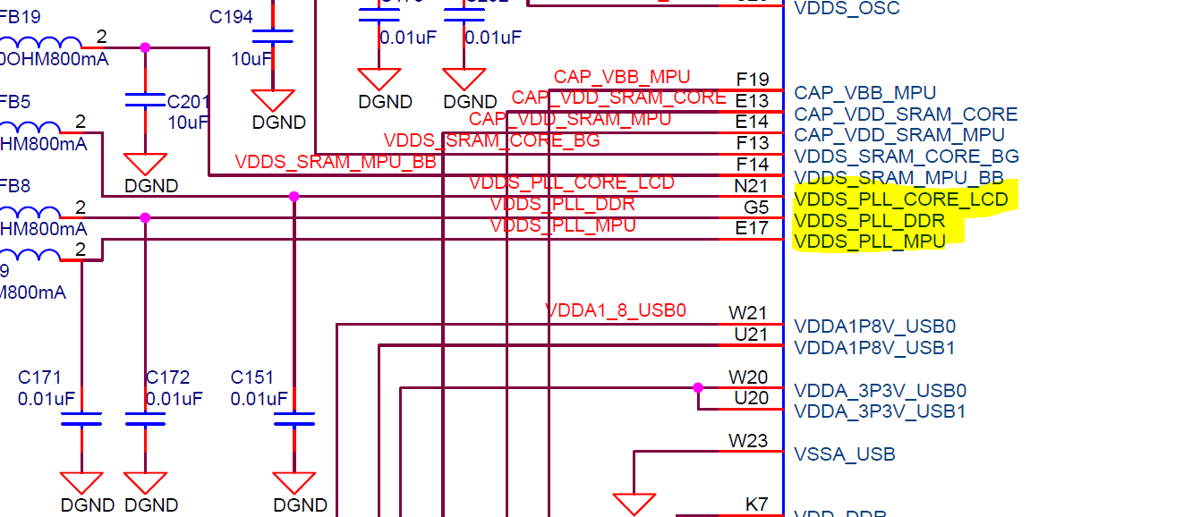

  • Hi Alex,
    1. I am wondering if you could please check the PLL voltages (below is the reference design for AM437x):
    2. After the board comes out of reset, could you please verify if the clock signal is stable with correct voltage level?
    3. Lastly, is this issue occurring on multiple boards or just one?
    Krunal
  • Hi Krunal,
    The board that has been debugged successfully before, this time just rebuilding, there are the same problems .
    So, VDDS_PLL_CORE_LCD, VDDS_PLL_DDR, VDDS_PLL_MPU, three voltages are 1.8V;the board comes out of reset is high, clock signal is stable. There is no problem.
    We have only made two such boards this time, and they all have the same problems.
    So, it is impossible to locate where the problem lies. I feel very doubtful.
    Thanks & Best Regards,
    Alex
