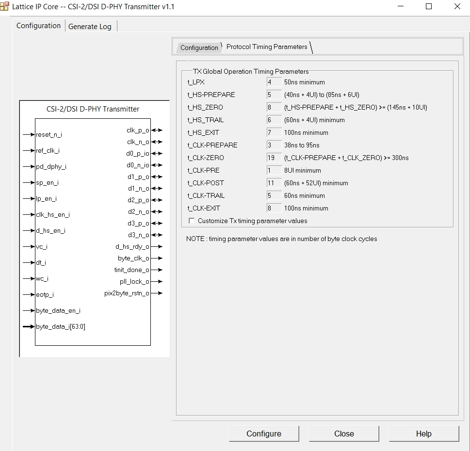

         We have a design about single radar and TDA2px evm board. The schematic is like this:  (AWR1243 [CSI-2]) -> ([CSI-2 in] [other processing] Lattice FPGA [CSI-2 out]) -> (TDA2px). I create a new usecase to receive the data from AWR1243. The radar can be programmed by TDA2px right now. In order to test the interface, I make the FPGA continuously send CSI-2 data to TDA2px. I also can clearly observe the csi-2 clk and data by oscilloscope. However, the issCaptDrvCallback is never called during testing.  Could you please let me know how the isscapture collect and verify the csi-2 data? What should I modified to launch isscapture if I don't use TI's reference design.

    Could you please help us understand which version of the SDK you are using and what is the usecase you are running?
    To check for the timing match between Lattice and TDA2px, could you also please check if there is any peculiarity with the Lattice CSI timing requirements?

  • Hi Piyali,
          I am using the PROCESSOR_SDK_VISION_03_06_00_00 and radar_capture_only usecase. I don't think there is any peculiarity for the Lattice CSI timing requirement. Enclosed please find the timing parameters for CSI2 Tx IP from Lattice.

  • Hi Frank,
    Can you please check on the following
    • Can you please ensure the CSI2 clock rates are configured correctly on TDA2Px side. i.e. While creating the driver we will have to specify the CSI2 clock rate, it take in DDR format (for 800 Mbps data rate, clock should be specified as 400 Mhz)
    • Can you please start FPGA to stream after TDA2Px CSI2 driver has been created and waiting to receive data
    Regards, Sujith

  • Hi Frank,
    Yes, when i say CSI2 driver, i mean issCapture.
    If the clock is configured correctly, please check on the connection. I am not sure how the FPGA is connected to CSI2 receiver pins. Could you please cross check on the connection (ensure +/- combinations are ok, even if they are swapped, we can configure while creating the driver. )
    Important to start the issCapture driver first and then start the FPGA (to rule out, source not waiting for termination to be enabled)
    Also, check at 0x42213304, if 29th bit is set, it would indicate LP transitions have been successful.
