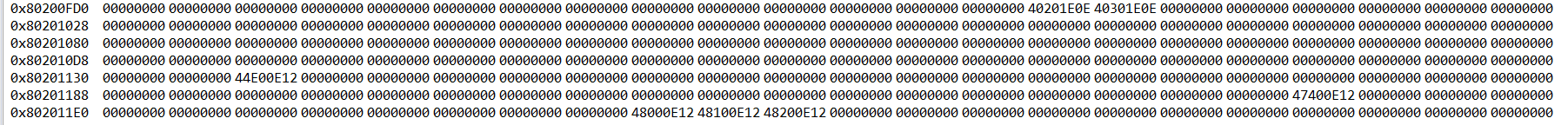

  • I'm running as a USB device. I have two programs that I can test, one that uses the CDC driver, the other does not. For both programs, when I manually read 0x47401460 from the Memory Browser in Code Composure Studio it shows up as ????????. I'm stopping at the same point in the code when I do the memory browser read.
    Kevin Jennings
  • Thanks. That looks like either USB is not powered up, USB clock is not turned on, or MMU has not been setup for this USB region. Are you using Processor SDK?
  • To your earlier post:  Nothing from 0x47401400, USB0 Core is readable (shows up as ???????? in the memory browser).  Nothing from 0x47400000 USB SS is readable either.
    To your later post about USB is not powered up, USB clock is not turned on, or MMU has not been setup for this USB region:  USB must be powered on and the clock running.  The two programs that I'm using are working functional code that have been in production for several years.  The only thing that I have added is to get status using HWREG(USB0_BASE + USB_O_DEVCTL), mask off bit 3 and pass that up to through our firmware stack to report on whether or not there is something connected to USB.  The one program uses the USB CDC driver, the other does not.  Since both programs are completely functional without the modification to add the single "HWREG(USB0_BASE + USB_O_DEVCTL)" statement, the problem can't be like USB not powered or clocks not running.
    I do have to correct one statement from my previous post.  USB0 Core registers starting at 0x47401400 ARE readable in Code Composer's memory browser window when I'm running the program that does not use the USB CDC driver.
    Since the data abort exception is happening right on the assembler instruction that performs the read from memory location 0x47401460 (aka USB0_BASE + USB_O_DEVCTL) this implies that the system is thinking that the address is invalid to be read from.  Since this only happens when using the USB CDC driver it suggests one of the two scenarios:
    - The non-CDC driver program does something to enable memory access to USB registers that the USB CDC driver program does not enable
    - The USB CDC driver does something to disable memory access to USB registers
    In either scenario, the fix would be to make sure that memory access to USB registers are enabled in the USB CDC program.  So now the question would be what is the mechanism for enabling/disabling access to USB registers?  If the USB CDC driver is intentionally disabling access, then a further question would be 'Why?'
    Kevin Jennings
  • Kevin,
    So, program 1 without CDC, program 2 with CDC
    - Both programs 1 and 2 functioning well
    - Program 1: USB0 Core registers starting at 0x47401400 ARE readable in Code Composer's memory browser window
    - Program 2: USB0 Core registers starting at 0x47401400 ARE read as ?????? in Code Composer's memory browser window
    Do you have MMU setup for 0x47401400 region in program 2? Just double check?
    Regards, Eric

    Look at this address from CCS memory window (the beginning portion may be zero, just scroll down):
    You see there are entries like 0X40201e0e, 40301e0e,...... 0x44e00e12, ..... 0x47400e12. ....
    This is the MMU table, the 0x47400e12 is for the address 0x4740_0000 with 1MB size, you may need to check ARM doc to decode what 0xe12 means. But at least you need have such entry in your MMU. Do you see this in working case and failure case?
    Regards, Eric
  • Eric,
    The MMU tables in both cases are nearly identical. For the working (non-CDC driver) program, the only non-zero numbers are 40201E0E, 40301E0E, 48000E12, 48200E12, 80001E0E,...80601E0E. The non-working (with CDC driver) program had the exact same numbers, but also three more: 80701E0E, 80801E0E and 80901E0E which immediately followed 80001E0E,...80601E0E previously mentioned.
    I didn't see any other non-zero entries. I don't know if placement in the table is important, I didn't check that. I was just looking to see what non-zero numbers existed in the table for each program.
    Kevin
  • Kevin,
    >>>>>>>For the working (non-CDC driver) program, the only non-zero numbers are 40201E0E, 40301E0E, 48000E12, 48200E12, 80001E0E,...80601E0E. >>>>>>> Can you confirm that without MMU you can read 0x4740_0000 address in CCS or code?
    In the failure case, >>>>The non-working (with CDC driver) program had the exact same numbers, but also three more: 80701E0E, 80801E0E and 80901E0E which immediately followed 80001E0E,...80601E0E>>>>>>>>> Are you able to find out how those entries are added by your code? Then add a similar entry for 0x4740_0000 region?
    Regards, Eric

    There are also the Page Table Visibility DSS API's which can be called from the CCS Scripting Console. E.g. to show there is a one-to-one mapping between the physical and virtual addresses for 0x47401400 which is for the USB0 Core:
    js:> ptvReverseLookup 0x47401400
    Physical Address = 0x0000000047401400 --> Virtual Address = 0x0000000047401400
    js:> ptvLookupAddress 0x47401400
    Virtual Address = 0x0000000047401400 --> Physical Address = 0x0000000047401400
        TTBR0 Base Address = 0x80200000
        Min VA = 0x0
        Max VA = 0xffffffff
            Type = L1 Section
            Index = 0x474
            Min VA = 0x47400000
            Min PA = 0x47400000
            Region Size = 0x100000
            S = 0x0
            AP[1:0] = 0x3
            nG = 0x0
            AP[2] = 0x0
            NS = 0x0
            TEX[2:0] = 0x0
            XN = 0x1
            Domain[3:0] = 0x0
