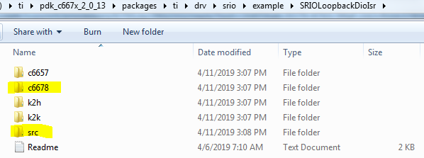

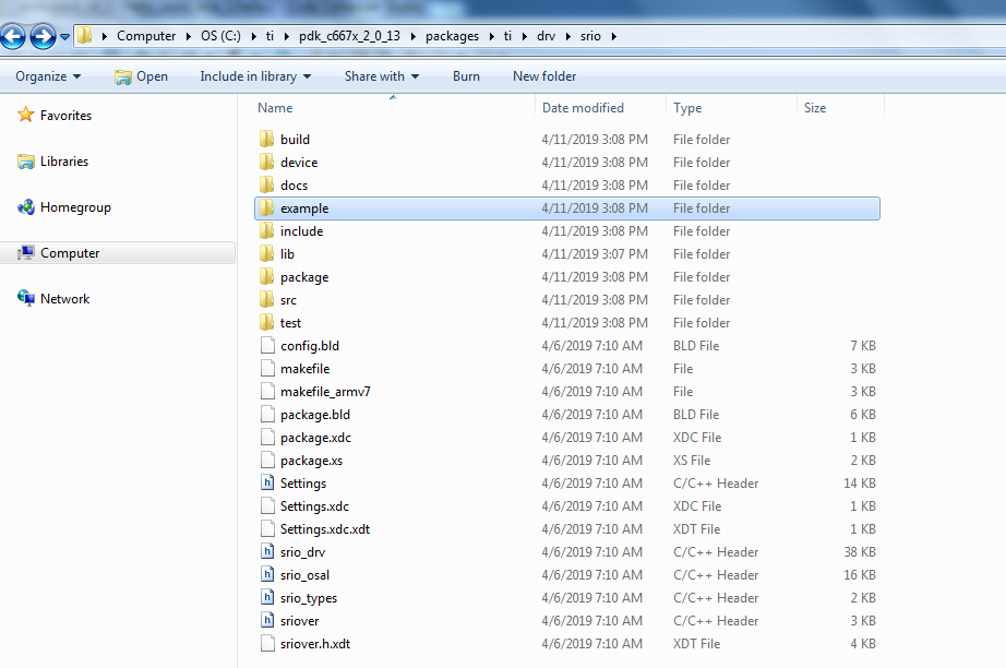

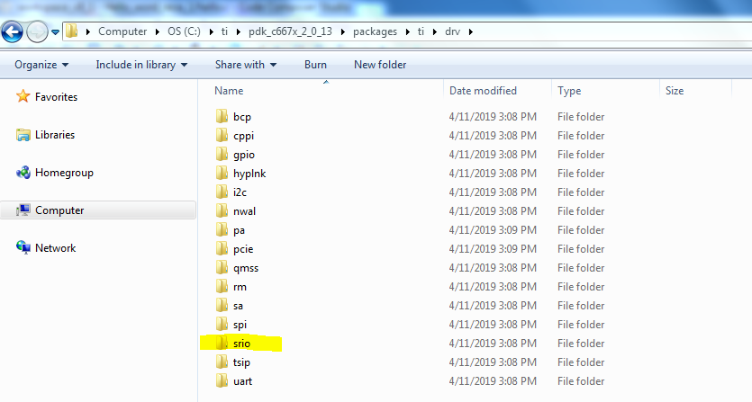

    I checked the folders on my system and found srio folder as follow:
    There are some folders and header files in the folder.

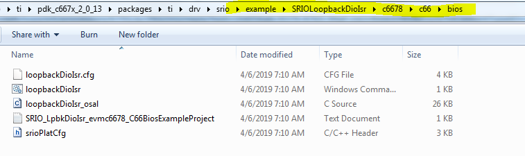

    In the "Example" folder there are following folders:
    My questions are:
    1- Which of the above folders I should import to CCS?
    2- It is needed to study "cppi_types", "qmss_types, "srio_osal", "srio_drv" header files in details? which of them are important?
    3- It is needed to run an operating system on target? Is it possible to use SRIO without operating system on target? which of the methods is easier?
    4- Is it possible to use SRIO on a single core on C6678 with 4Gbps?
    5- Is there any online solution to debug simple programs for people who do not have any board/device?
    Thank you for your attention.
    For questions 1 through 3 I mentioned how you can create the SRIO examples in my previous post. You should import the newly created folders in ~/ti/pdk_c667x_2_0_12/packages/MyExampleProjects. When you import a project in CCS you will see which header files are included and you should study those headers.
