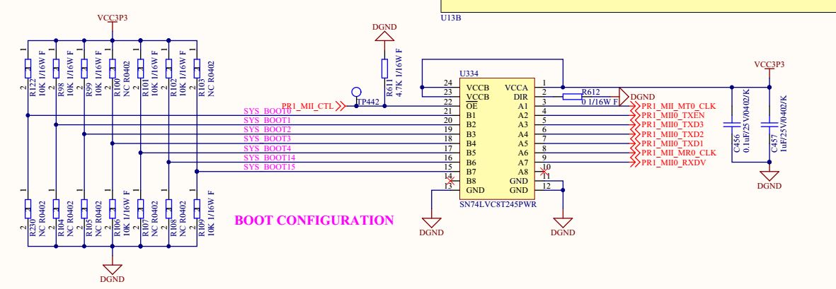

1,I wonder what is the purpose of this design U10 ? This schematics is from AMIC110_ICE_EVM.

    1. U10 is the isolation switch to connect the two PHY1 signals that were isolated during power-up. PHY1 signals are connected to AMIC110 pins that operate as SYSBOOT inputs. Two of the PHY1 signals must be isolated from AMIC110 SYSBOOT inputs during power-on. The dual FET switch, U10, performs this task. The switch control inputs are connected to GPIO2_18 (pin L17) begins high-z with an internal pull-down after power is applied. The internal pull-down along with an external pull-down insures the switch is off as soon as power is applied.

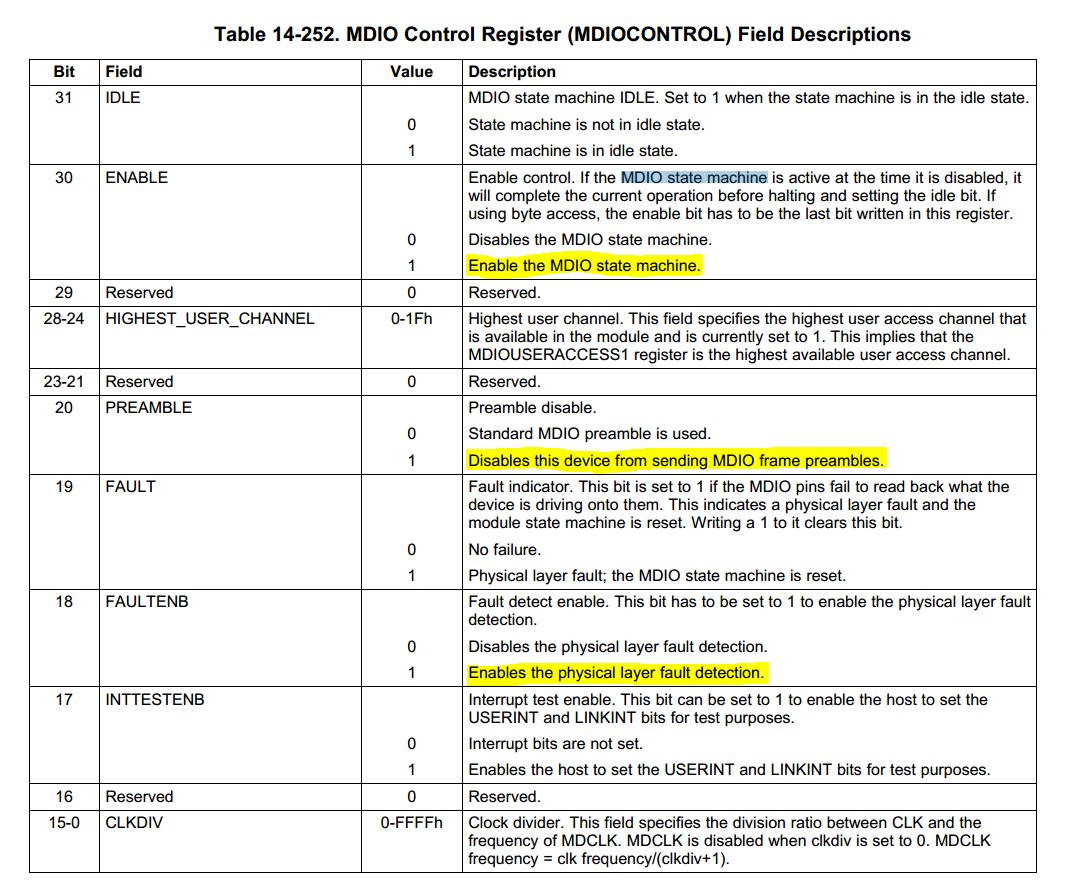

    CSL_MDIO_init((((PRUICSS_HwAttrs *)(pruIcssHandle->hwAttrs))->prussMiiMdioRegBase), 200000000, 2200000u); After the statement is executed.
    You can find this statement in the EtherCAT demo program. It is before the PHY configuration program and PRU Enable.It means that the PHY is not configured and PRU not run.PHY1 is error, PHY9 is ok .Why?
    But this statement enable the MDIO and MDC to start working.So I doubt that the PRU change the PHY  register by MDIO and MDC.Can you tell what the PRU changes by this statement ?
    Or What the PRU read and write to the PHY ?I need to know these to analyze the problem.

    I have some questions about the MDIO configuration.
    1,CSL_MDIO_init((((PRUICSS_HwAttrs *)(pruIcssHandle->hwAttrs))->prussMiiMdioRegBase), 200000000, 2200000u); the statement does the following three things.
    Disable preamble , enable fault detection,active MDIO state machine.
    Why does it cause RX ER to output error ?

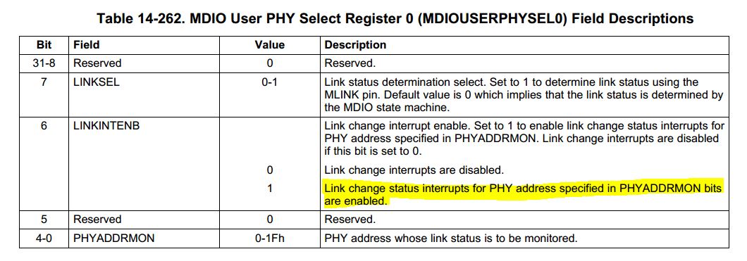

    2,"Link change status interrupts" What does it mean ?
    //Select PHY address enable link change interrupt at MDIOLinkIntMasked and MDIOLinkIntRaw
        if(pmdio_params->enhancedlink_enable == 0)
            MDIO_enableLinkInterrupt((((PRUICSS_HwAttrs *)(
                                           pruIcssHandle->hwAttrs))->prussMiiMdioRegBase), 0, pmdio_params->addr0,
                                     MDIO_LINKSEL_DISABLE);
                                           pruIcssHandle->hwAttrs))->prussMiiMdioRegBase), 1, pmdio_params->addr1,
        else
                                     MDIO_LINKSEL_ENABLE);
    void MDIO_enableLinkInterrupt(uint32_t mdioBaseAddress, uint32_t phyInst,
                                  uint32_t phyNum, uint8_t linkSel)
        uint32_t PhySel;
        PhySel = phyNum;
        PhySel |=  0x40;
        if(MDIO_LINKSEL_ENABLE == linkSel)
            PhySel |= 0x80;
        MDIO_userPhySel(mdioBaseAddress, phyInst, PhySel);

    PRU module clock is enabled during Board_init() and MDIO module remains active before CSL_MDIO_init() which enables the MDIO state
    machine, uses standard pre-amble and sets the clock divider value. After MDIO module is initialized, the PHY registers can be accessed, and this can be confirmed by CSL_MDIO_phyRegRead() or CSL_MDIO_phyRegWrite() which always wait till transaction completion if any in the beginning. PHY register read, e.g Board_getPhyIdentifyStat() internally calls CSL_MDIO_phyRegRead().

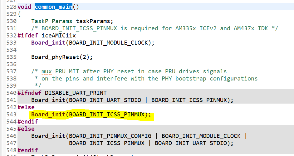

  • Hi Garrett,

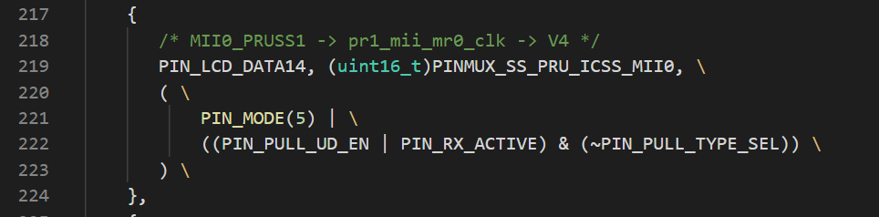

    I changed the pin configuration when I create the project. So that's not the problem.PHY 9 always works well.
    1,Why did the RX_ERR of DP83822 start to make a error signal when "Enable the MDIO state machine"(CSL_MDIO_init()).I want to know why does the error signal  make at this time point.
    2,Why does the ICEv2 use U10 ?In other words, why did AMIC110 ICE use this isolation design but ICEv2 not?Because the periodic communication error occur in PHY1. PHY1 and AM3357 boot pins exist multiplex pins.
    But it does not affect the boot run of AM335x.
    This values is read from 0x467 and 0x468.You can konow the Hardware Bootstrap Configurations. The mode of RX_D2 is different because the address of PHY is different. It doesn't seem to affect the PHY bootstrap.
    By the way, did your expert review our schematic ?

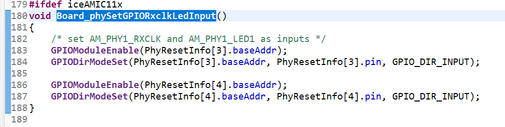

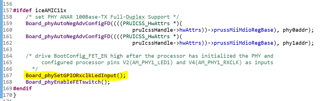

    I've been comparing the demo program between AMIC110 and AM335x.
    Why are pins repeatedly configured in the different program locations in AMIC110 ?I think that their configuration have the same effect.I am confused.
    I also found that Board_phyReset() is before the pin configuration in AMIC110 but the AM335x is just the opposite.

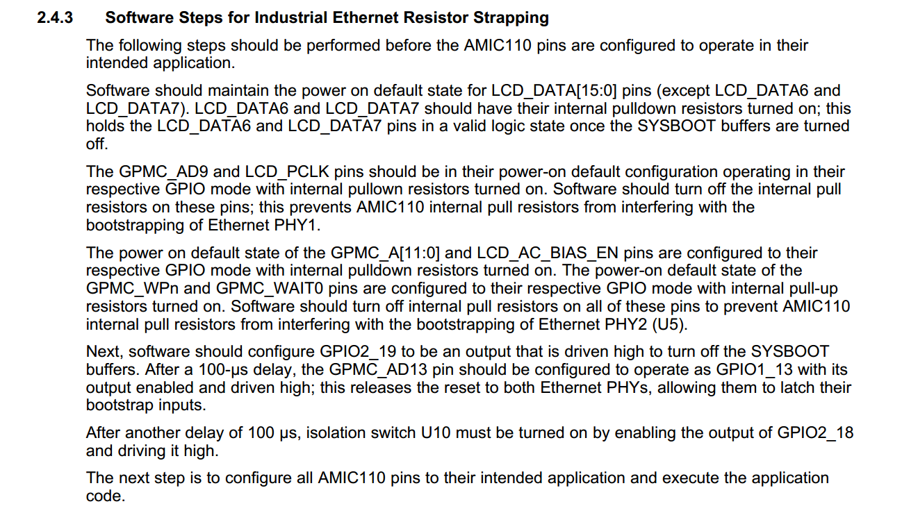

    I know these configuration has to do with this description in AMIC110 ICE user's guide.
    I am confused. If the isolation switch U10 prevents AMIC110 internal pull resistors from interfering with the bootstrapping of Ethernet PHY1,why didn't PHY2 have the same isolation design ?
    My understanding is that it just prevents PHY1 internal pull resistors from interfering with AMIC110  bootstrap. Is it right ?
    Andy
  • Andy,
    That's right - the AMIC110 pins connecting to PHY1 are LCD_DATA[x] whereas pins connecting to PHY2 are GPMC_A[x], and see AMIC110 data sheet section 4 - Terminal Configuration and Functions: (5) LCD_DATA[15:0] terminals are respectively SYSBOOT[15:0] inputs, latched on the rising edge of PWRONRSTn.
    Garrett
