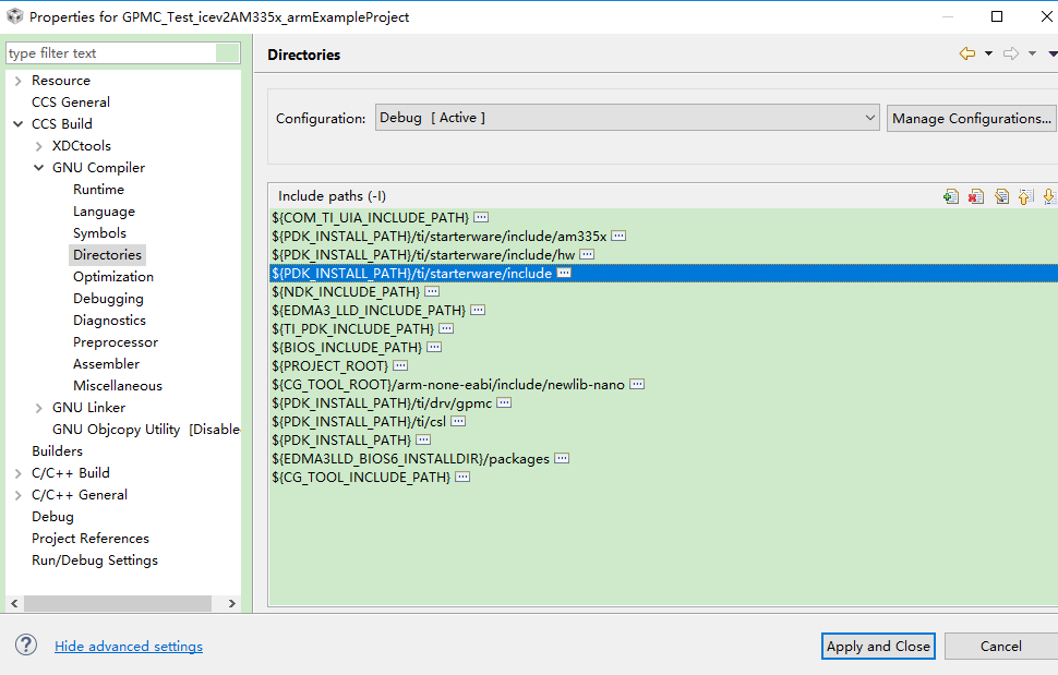

    Can I use the api from C:\ti\pdk_am335x_1_0_13\packages\ti\starterware\include\edma.h ?which is on starterware.
  • how can I call the API on RTOS CCS project,when I include the head file and call the API it shows :undefined reference to `EDMAInit'.
    I have modified the prohect's properties like this:
  • Hongping,
    EDMAInit() from pdk_am335x_1_0_13/packages/ti/starterware/include/edma.h is used only for Starterware examples, like the one below:
    pdk_am335x_1_0_13/packages/ti/starterware/examples/example_utils/edma_utils.c
    If you are not using the legacy starterware examples, I would suggest you to use below EDMA library, which is used in the RTOS McASP example I have provided in my first reply.
    pdk_am335x_1_0_13/packages/ti/drv/mcasp/example/src/audioSample_io.c
    pdk_am335x_1_0_13/packages/ti/drv/mcasp/example/src/audioSample_main.c
    #include <ti/sdo/edma3/drv/edma3_drv.h>
    #include <ti/sdo/edma3/rm/edma3_rm.h>
    #include <ti/sdo/edma3/drv/sample/bios6_edma3_drv_sample.h>
    #include <ti/csl/csl_edma3.h>
    These H files are located at:
    edma3_lld_2_12_05_30C/packages/ti/sdo/edma3/
    pdk_am335x_1_0_13/packages/ti/csl/csl_edma3.h
    Pavel
