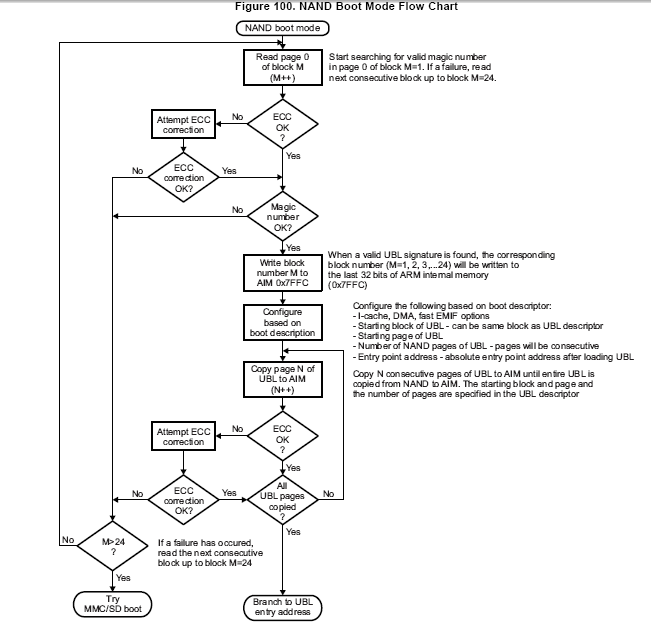

    I have a question about RBL loads UBL on DM365. As i understand, the RBL searchs UBL descriptor(margic), then loads UBL to IRAM according UBL descriptor(margic), but if the starting block position of UBL in nand flash is bad block, and the valid UBL is stored at the next block, in this case, it seems RBL can't skip the bad block and loads the next valid block, just skip the current block of UBL description and re-search UBL descriptor again up to 24 blocks.  Right?
    So when building total firmeware (including UBL descriptor, UBL, u-boot, kernel, filesystem) for flash programming in mass production, we will define the start block of UBL for UBL description, but after flash programming, the start block position of UBL  in flash may be bad block, and the valid UBL is stored at the next block, in this case, it seems RBL can't loads UBL. How to deal this issue for mass production? Thanks for any advice.
    The Nand Boot Mode Flow Chart got from TI is attached for your information.
    Best Regard
  • My recommendation is to place multiple copies of the descriptor and UBL in various blocks of the NAND (the descriptor goes in page 0 of a block and the actual UBL data would go into the remaining pages of a block).  Each descriptor must be different to correspond to its copy of the UBL.  If during programming a block is found to be bad, you should not try to move the content you were going to write to the next available block, rather you should just skip writing that copy of the UBL.  Otherwise, the descriptor will be wrong and will be pointing back to a bad block.
    Best Regards.
  • Thanks, Tai.
    But in this way, it seems hard to program NAND flash with the whole FW(including UBL,u-boot,kernel,filesystem,...) for mass production.  Any other way?
  • Sorry Feng. I don't see any other way to get around the problem.
