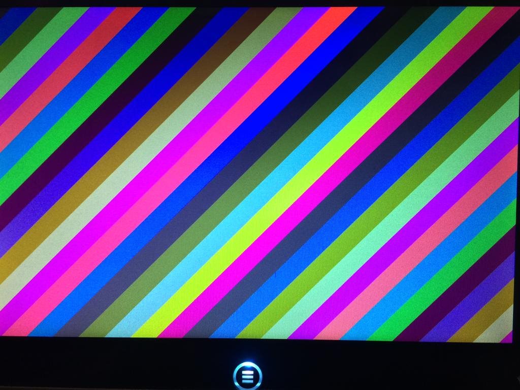

While running kmscube sample application it shows weird colors like this one.

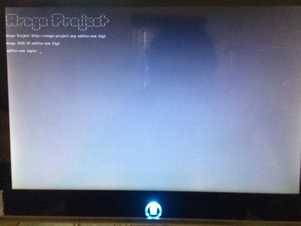

While default login prompt screen looks ok .
Does it related to EDID or EGLFS?

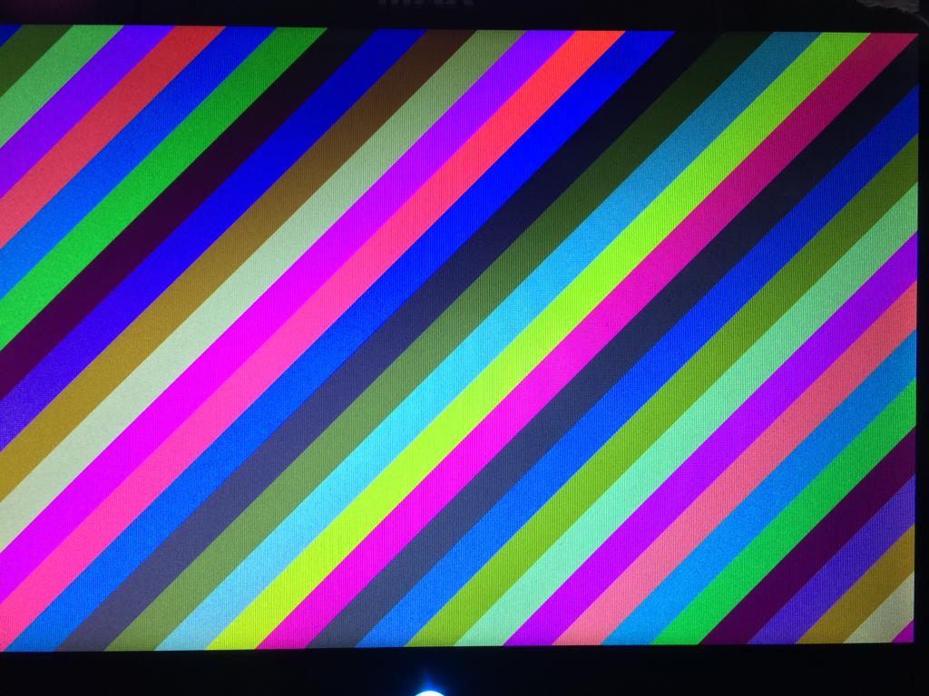

    Here is the output of individual modetest on separate plane ids

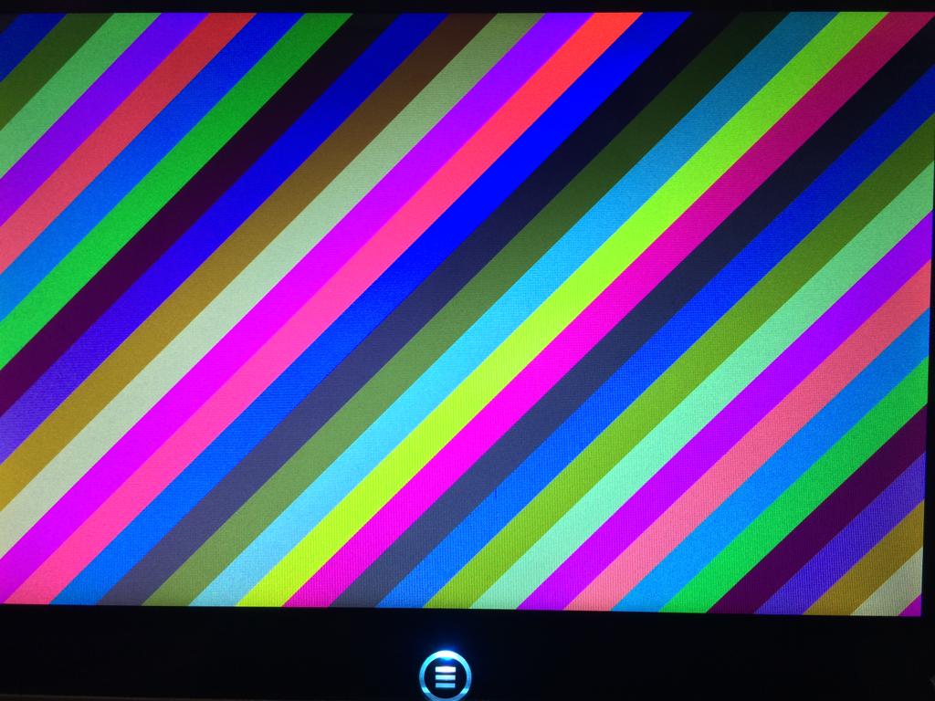

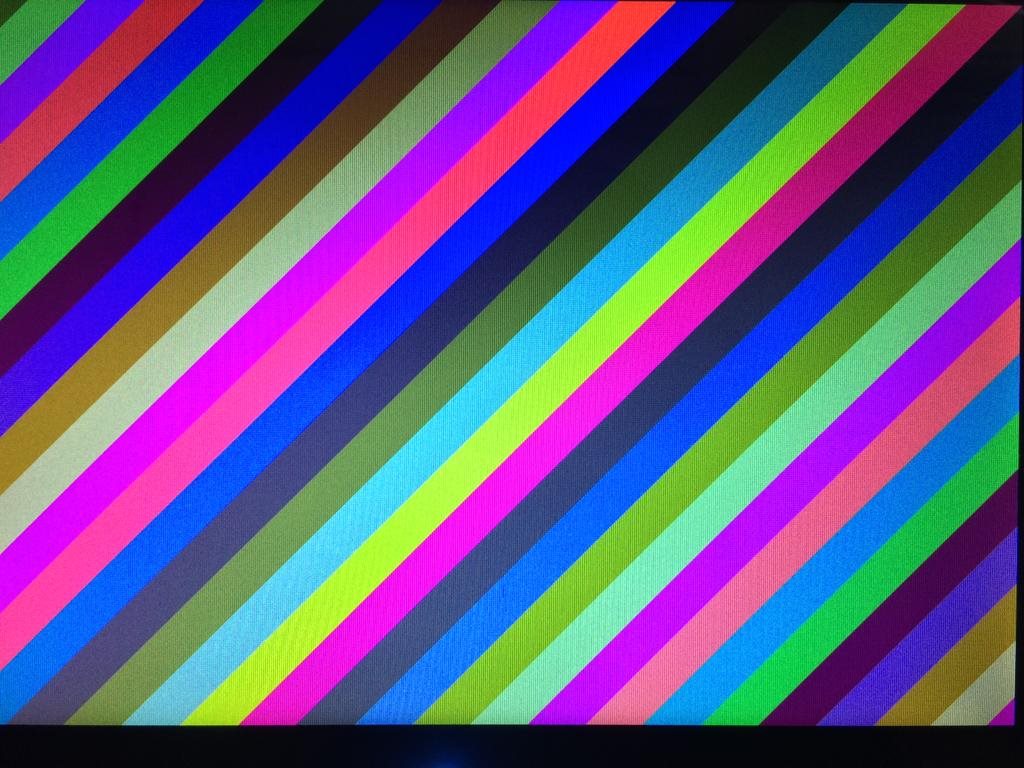

  • How does your display output look for the last three modetest run?
  • Here are the outputs of those commands
    modetest -P 50@39:1280x800@RG24
    modetest -P 45@39:1280x800@RG24
    modetest -P 40@39:1280x800@RG24
