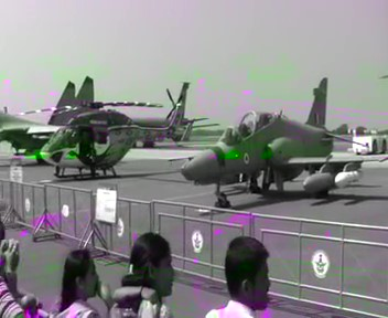

Hi TI experts,
We are trying to use H.264 encoder of IVA-HD but it generates color faded image with artifact. (please see below still image which converted .h264 to .mp4 by using ffmpeg)
The target platform is AM5728 GPEVM and the version of processor-sdk is 05.03.00.10 (Latest).

The encoding task is successfully done, then we convert the output file(.264) to .mp4 by using ffmpeg to check the video image.
Is there any process I miss ?
How can I clearly identify the problem?
    Gstreamer plugins are already included in PSDK. No need to rebuild them except if you modify the source code for some reason.
    Please try this
    gst-launch-1.0 filesrc location=airshow_p352x288.yuv ! videoparse width=352 height=288 format=nv12 ! video/x-raw, width=352, height=288 ! queue ! ducatih264enc ! h264parse ! queue ! mp4mux ! filesink location=1.mp4

    I do not see artifacts.

    We found that the format of yuv file which we use was "YV12". We need "NV12" for the encoder on IVA-HD.
    Recently, we also design the h264 encoder on DSP (C66x), so we mistakes yuv files (Unfortunately the name and footage of files are same...)

    This is correct the ducatih264enc requires NV12.
