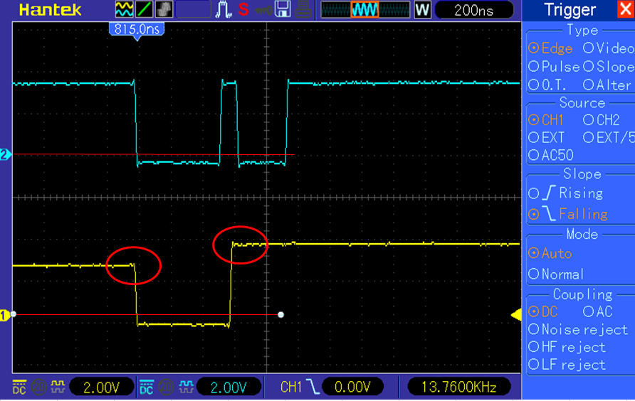

We are trying SPI Boot using SPI Flash (NOR flash).
However, we are not able to success SPI boot.
As I showed bellow picture,  RBL don't read Flash data via SPI after POR.
Could you please give us debug advice ?
What we debug now is:
FROM assigened to SPI0 CS0.
SYSBOOT pins setting
SYSBOOT[4:0]   = 10110b or 11000b or 11001b  ->Thiese are SPI high prioritys
SYSBOOT[5:13] = 0
SYSBOOT[14]    = 1
SYSBOOT[15]    = 0
・We followed AM335x Wiki [ON is labeled on the wrong side of SW3 boot mode switch.] Also
  • Kaz,

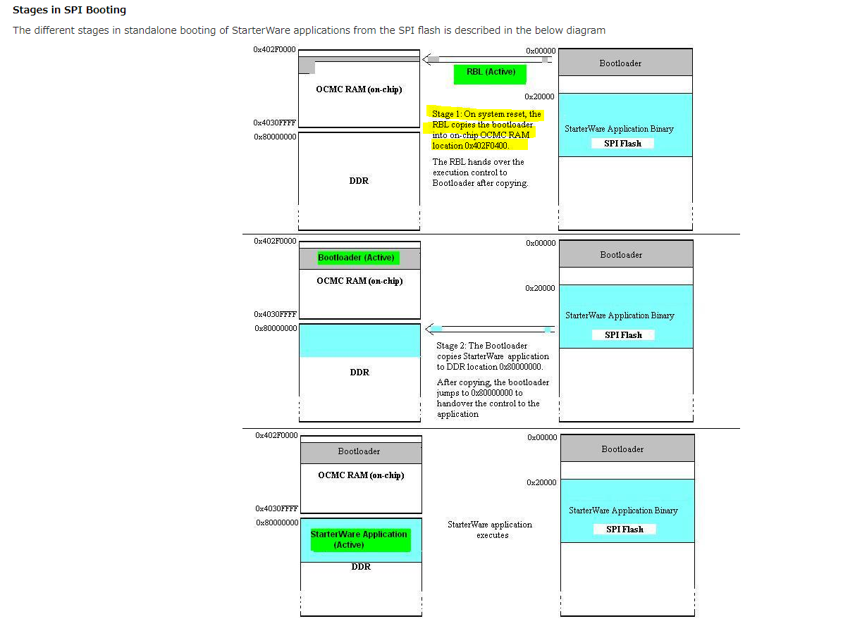

    Is this on TI EVM or on custom board. In offline email, you indicated that customer followed this SPI boot step in wiki. And they failed in Stage 1. (On system reset , the RBL copies the bootloader into on-chip OCMC RAM Location 0x402F0400.)
    Are you saying that AM335x device doesn`t boot on POR but if customer performs system reset after POR, the RBL is able to copy the bootloader into on-chip memory.  If the statement is true then the issue is not related to SW or the boot image format and seems to be related with power up sequence. Is this a custom board or TI evaluation HW.
    I am also attaching the scope shot from the board that you have provided . Looking at the scope shot, I am not sure why there are some signals going below 0 and also why the level high on the board is not at 3.3V

    -This is TIEVM + custom board (only SPI flash memory parts).
  • Kaz,
    Any update on this issue. Has there been any tests on the power sequencing and SPI signals that you can provide for our HW expert to look at.
    Rahul
    Actually, we miss connected SPI Hard pins. When we review this pin connection. This issue was fixed. So, we fixed this .
