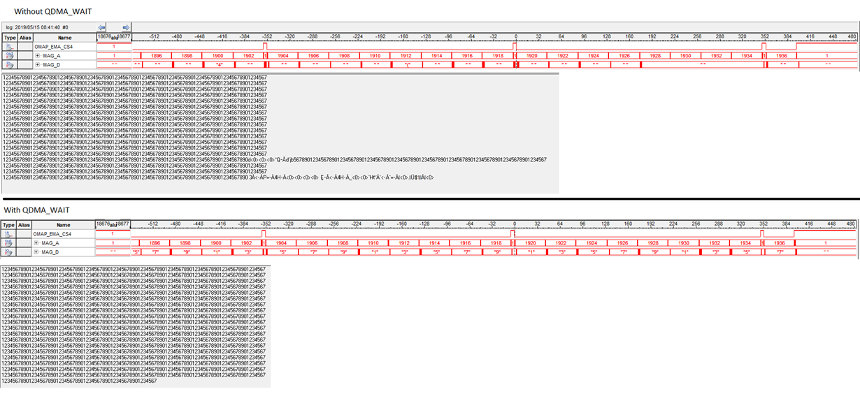

Hey,
I am using QDMA to send data using EMIF. My problem is that with long words > 1950B, the last data is destroyed (with all the words everything is transmitted correctly). I noticed a similar problem when writing files to an SD card using EDMA. In my project cache memory is disabled. Can this be the cause of the problem? It doesn't use any functions in the project to flush cache memory, etc.
Please help.
Regards, Patryk.

  • Hello Sahin,
    Thanks for your support. I solved the problem with MMU but this didn't solve problem with DMA.
    When I send more than 1464B via EMIF I looked strange things in EMIFA data bus BUT when I waiting after calling "START_QDMA" function:
    while( (QDMA_CFG_IPR & 0x1) != 0x1){;}
    this problem doesn't appear..
    I have enabled MMU but disabled cache.
    Where is the problem? I think I have a similar problem with the SD card.
    Patryk.
