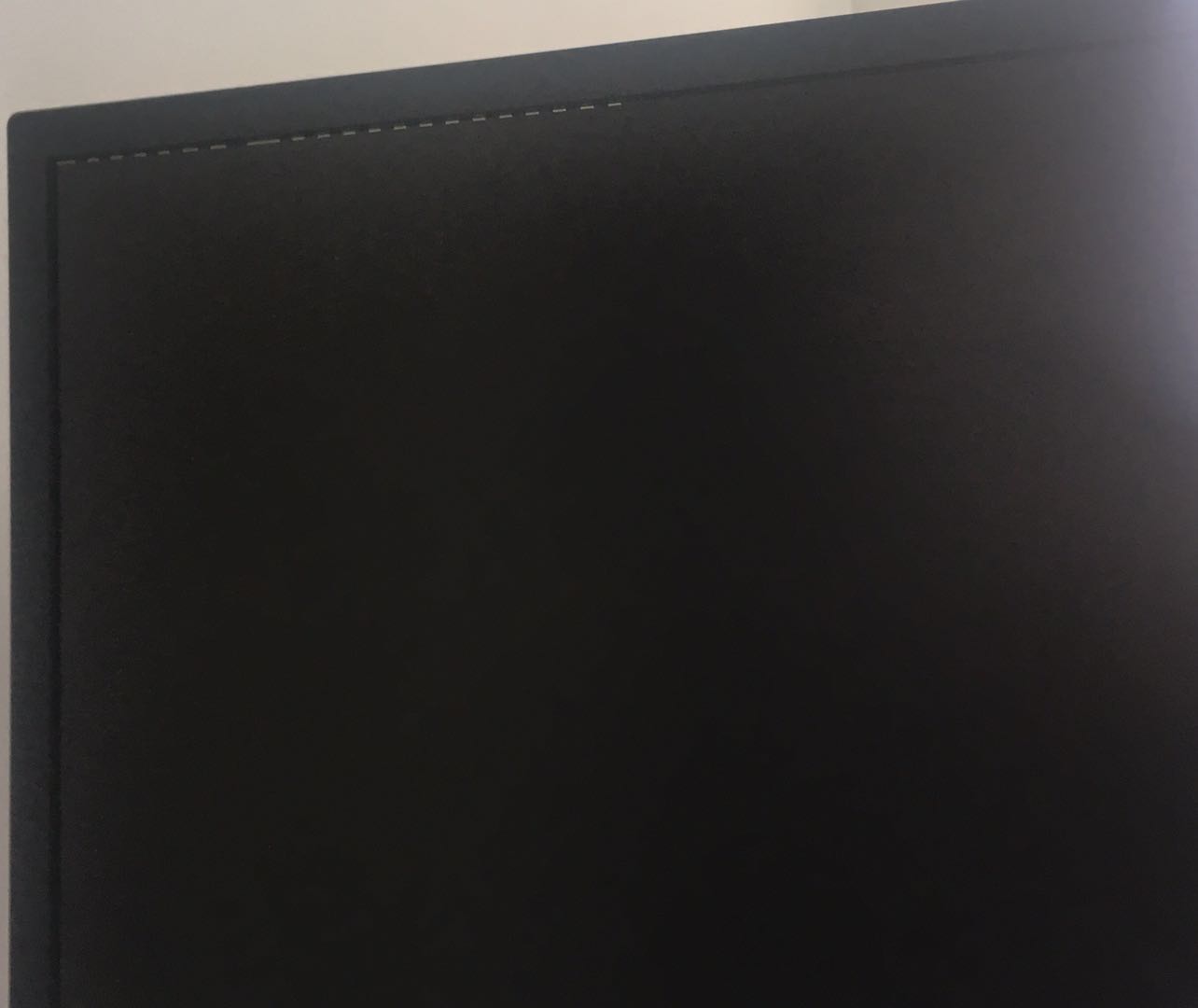

Hi
I design a board based on TDA3x, The Analog video is used. But the PAL vedio is not right which had half dotted line as follow. The N vedio is ok
We used the default configure as TDA3xEVM
Whad happened
    Do you mean the view comes correct? but there is this line at the top of the view??
    It might be blanking data, can you move video position by lines and see if it goes away?
    Rgds,
    Brijesh
  • Hi
    The camera is not work!
    The vid pipeline had not data
    Is the GFX pipeline problem?
  • No, GRPX not a problem.
    GRPX comes even when capture does not work..
    Can you share your usecase file?
    Rgds,
    Brijesh
  • OK
    I will upload the file for you also with the log files
    I running the usecase without camera to exclude the factor of the camera data!
    One log file show the display link is running,  and the other log files the display links running failed which I change the display link code. But the PAL output is the same as showing before. which had half dotted line
    Maybe there are problems in VENC or SD_DAC. But I use the default configure for there module!

    my_fpd_display.rar
    I still have not got the chance to look into the usecase,
    i will have a loot at it tomorrow and get back to you.
    Brijesh
  • Oh
    But I still do not had the replay!!
  • I will have a look at the usecase..
  • Hi
    do you know why this happened??
