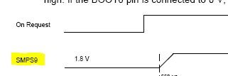

The PMIC chip of one of our debug boards was damaged during use and we are troubleshooting the cause. We want to know which PMIC internal conditions will affect the normal output voltage of the SMPS9 channel ?
the SMPS9_IN has a normal 3.3V voltage input, but after the POWERHOLDG is powered by 5V, the SMPS9 channel does not have a 1.8V voltage output. As we know,  SMP9 is the first power-up sequence after the POWERHOLD pin of O9039A387IZWSRQ1  is enabled.
In addition,we have removed the SMPS9 load circuit, including the Path which SMPS9  power to VIO_IN , but it is useless.

    This looks like it is not SMPS9 that is the issue if all rails are not turning on. If POWERHOLD is high and the device is not turning on, there may be a few possible issues:
    1. Is a "Gating ON Request" present? This keeps the device off.
    2. Is an "OFF Request" present? This keeps the device off.
    These lists of requests are also in the datasheet. If the device is damaged, you may not be able to tell what internal condition is keeping the device off. How did you confirm the device is damaged? Was a short measured somewhere? Was there visible damage to the PMIC or external components?
