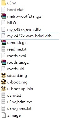

     I'd download linux v5.x and try to install it on my board, but it hangs all the time with the message “Starting kernel ... “.
    In my testing, the XX.dtb in kernel 4.14 is simply replaced by the one in kernel 4.1, since the board was got from a third party but not ti-dsk version. Is it correct if only taking care of the XX.dtb file replacement for different board ?  Please advise a simple way to test the problem I faced. Thanks for your highly support.
    As the kernel versions progress node definitions change as well, this means the DTS that is created must be updated to match the kernel and driver requirements. That would explain why using a dtb that works with a 4.1 kernel does not work with a 4.14 kernel. Do you have the source to both DTS files?

    I have few DTS files. So, what I need to do is to copy those DTS files to dts directory and append those file’s name into the Makefile in dts directory, and left everything else unchanged. Is that right ?
    If so, there are few questions as below,
    1. As you mentioned that all things have to match. Does It mean MLO and u-boot.img should also be upgraded but not using the old ones ?
    2. My board is upgraded with a SD card. I used to copy some files such as rootfs ,zImage, XX.dtb into the SD card, and execute ./updatesys.sh to make it updated. Is it possible to have the same way to get it done ? Or can you provide a procedure to make it ?
    3. As attached there are few other files except for those mentioned above. Where can I get those files to make it complete ? (such as ramdisk.gz, rootfs.ubi, rootfs.ext4,…etc)
    sr
    I think that is a good idea to at least review the root file system to make sure it is compatible with the kernel version that you are planning to use. for the moment you should be able to use the existing MLO and u-boot. I want to discuss your question on the DTS files and the board upgrade mechanism.
    To move a custom board DTS from one kernel version to a later version will most likely involve a review of the nodes in the DTS to make sure all the required properties for a driver have been met. As I mentioned earlier as the kernel is modified DTS node required properties often change in a way that are incompatible with earlier kernel versions. The problem you are currently facing is most likely due a node in the DTB not having the correct information necessary for kernel initialization. In short re-compiling the DTS against the kernel version may not be enough to get it to boot.
    One suggestion and it is a manually visual one which is to go through each of the nodes in the DTS file and compare the nodes to the TI SDK DTS files. While the boards are not the same the node properties sometimes are very close and could be used as a reference to identify the node that is causing the issue. You could also set the status=disabled for each node except the console node and see if you get the kernel to start booting. Then add in each node one at a time by using the status=okay.

  • Hi Schuyler,
    Yes, the board was purchased from a vender and they also provide SDK to go with it. But the problem that we are facing had mentioned previously. So we expect we can get a good result by testing 4.13 as you suggested.

    Thanks for your suggestion. I went through all of the nodes in the DTS file and had revised it. It seemed making a big progress without hanging to “Starting kernel ... “. And the system was almost booting up successfully. But it still got a problem at a finished step as attached in the following boot log.
    Your response will be highly appreciated. Thanks.
