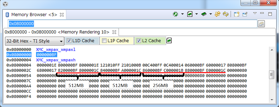

The memory window value is
Test 2 : (Success)
Divide three address setting for 512MB +512MB+ 256 MB MPAX setting
Set logical address 0x8000_0000 => Physical address  0x8_2000_0000 (512MB)
       logical address 0xA000_0000 => Physical address 0x8_4000_0000(512MB)
      logical address 0xC000_0000 => Physical address 0x8_6000_0000(256MB)
Result => we changed maximum area to 512MB,  MPAX is working.
We monitor this test on the memory map
This is "Test 2" window

    Then I added two entries for MPAX pair 4 and 5, where 4 mapped 0x:8:2000:0000 to 0x8000:0000 with 1GB, and 5 mapped 0x8:6000:0000 to 0xc000:0000 with 256MB.
    0x08000000 000000BF 0000001E 800000BF 8000001E 121010FF 2101000B 00C400FF 0C400014
    0x08000020 820000BF 8000001D 860000BF C000001B 00000080 00000000 00000080 00000000
    I use the CCS physical view and memory view to compare the mapping. It is true that 8:6000:0000<----->c000:0000 correctly mapped. However, 8:0000:0000 <----->8000:0000. Not the newly programmed 8:2000:0000<----->8000:0000, that is the MPAX 4 didn't take effect, although it should override lower MPAX pair.
    2) To verify your idea of alignment, I deleted MPAX 1 (fill with 0).
    0x08000000 000000BF 0000001E 00000080 00000000 121010FF 2101000B 00C400FF 0C400014
    It didn't change the behavior. Still 0x8:0000:0000<-------->0x8000:0000
    3) Then I change the alignment, that 3 blocks each of 512MB, the alignment is also 512MB
    0x08000020 820000BF 8000001B 840000BF A000001B 860000BF C000001B 00000080 00000000
    The 3 regions mapping worked.
    So, it does look there is an alignment requirement. However I didn't find it in Corepac MPAX section. Let me check and update here.
