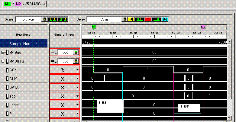

I'm working on a project based on  TMS320C6748
I want to  to use the Serial Peripheral SPI_0 . For such operation I will hand the SPI_0 driver supported by ti , I see that there is a gap between the first byte and the remaining bytes depends  the operating mode it was selected ,why does this driver operate on this strange way ??. What must I modify  to be able to work under bursting mode but all byte from the first to last byte on consecutive way opearaion .  /....................

    I am using a the last version of driver provided in BIOS  .
    When is used the spi driver supported by ti ( to send 5 bytes :   1ADD+4 DATA ) the result is shown in the att file  :
    First cs : 6us (1st byte= ADD) after that a long gap why ??? and finally is sent the remaining  4 bytes (6us) in total
    All cycle (M1—M2 logic) 25.91 us , how is possible when the set time clk is 50 Mhz (max frq allowed 20 ns)   so estimated time  8+32bit= 40 bit so 40x20ns 800 ns like 1us but no  25us ,what happened here is it impossible work in this way   . my require time is <1.2us = time cycle .

  • After asking some SPI hardware experts, they do not see why there is a gap in between the transactions.  From their experience, it was mostly continuous (with very small equal delays between the transactions).
    I'm going to move this to the BIOS forum.  Hopefully, the people who developed the driver can see if there are some constraints with the driver.

    I need to know what must I do to send 5 bytes so 1 bytes add+4 bytes data  in less than 1.2 us , according to data sheet must be less than 900ns but no 25 us , so pls . I need somo example to check on my EVM: OMAP-L138.   This answer will be important for all users that need operating the SPI PORT at high frequency .And no with the actual driver that opearates like was named and showed ( 26 us to send 5 bytes !!!!!!!!).
