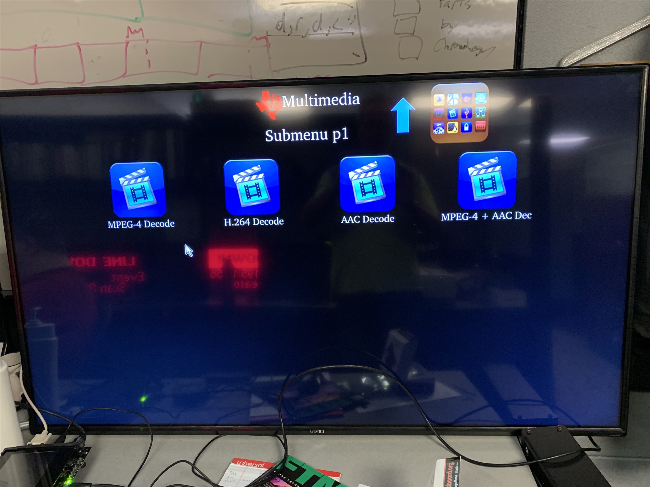

  • Hi Bill,
    So we installed PROCESSOR-SDK-LINUX-AM437X (v05.03, 07-APR-2019, kernel ver v.4.14.79) and booted successfully.
    We selected the HDMI successfully and when we played the audio-videos clips, no audio come from the TV.
    We have tried all apps in the Multimedia screen. (see the attached photos)
    Can you explain how the McASP and SiI9022 are setup to produce sound? As I mentioned above, I cannot understand how it will work with the implemented hardware circuit.
    Can you also give us the configuration of the EVM that produces audio and video through the HDMI port?

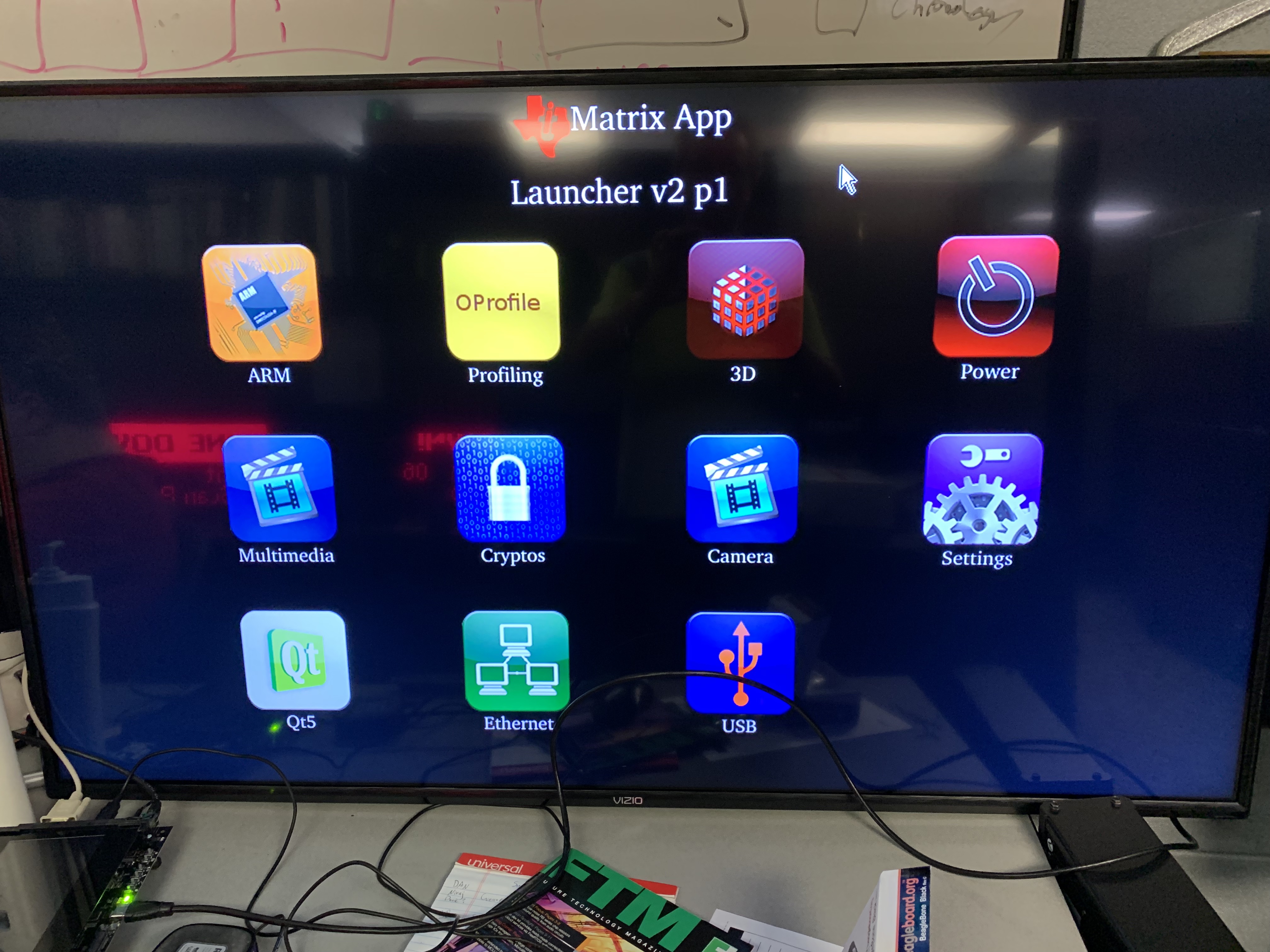

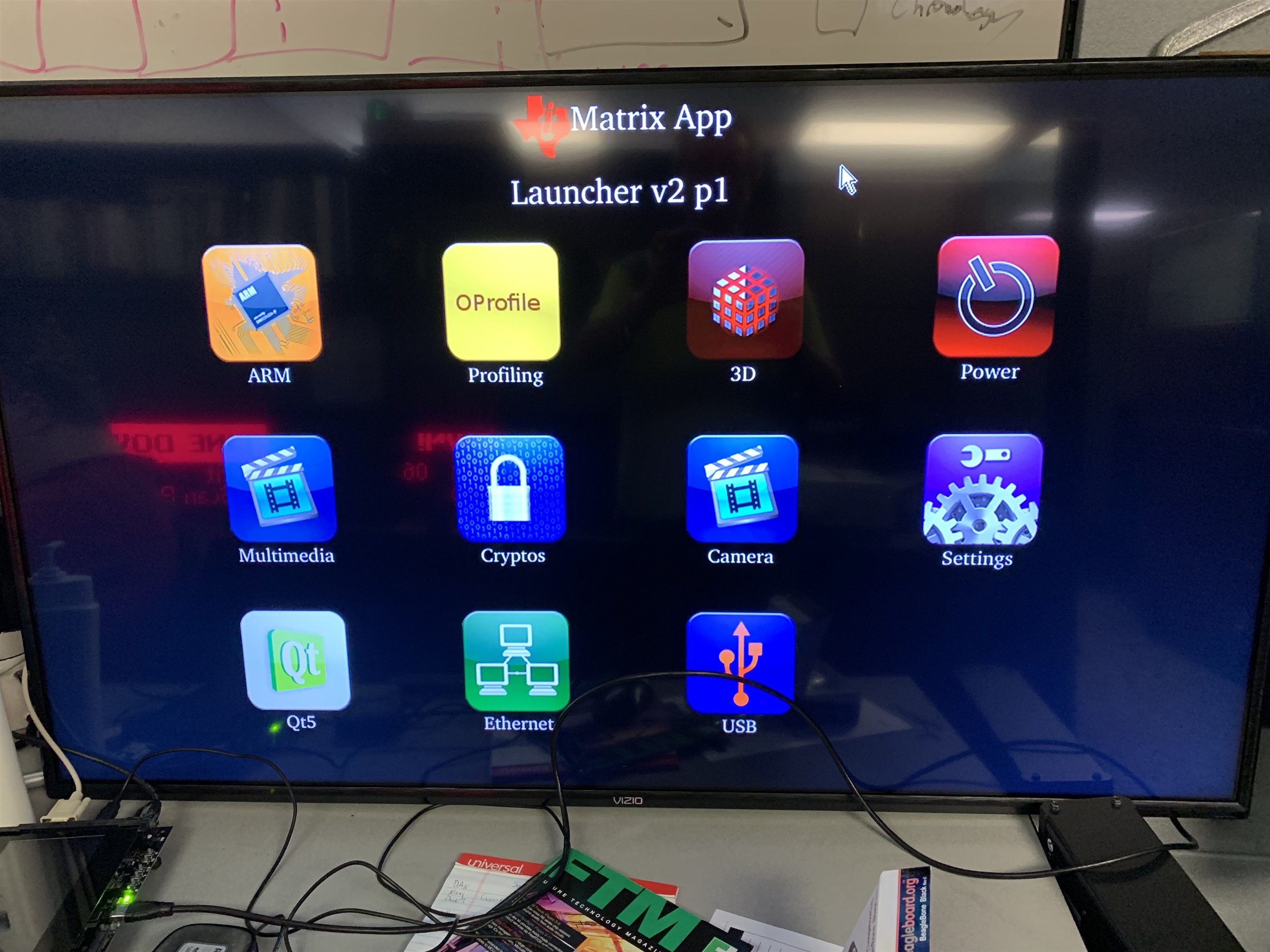

  • We run the latest SDK 5.03 and we are not getting any sound from the TV. We have tested the TV sound and it works fine.
    When we programmed the SDK 5.03 and run it, the matrix browser didn't come up automatically so that we had to start it manually. The picture quality is lower that when we run the SDK that came with the EVM. It looks like the new SDK code may have problems communicating over I2C with the SiI9022 HDMI transmitter.
    In any case, when we run the matrix browser manually, we were able to run the AAC decode and MPEG4+AAC but there is still no audio. Here is the output from the Linux console:

    Here is the TV monitor output when we run the AAC decode: (no sound is heard)
    Keep in mind, that the sound works in LCD mode, although it is produced by the TLV320AIC3106 codec.

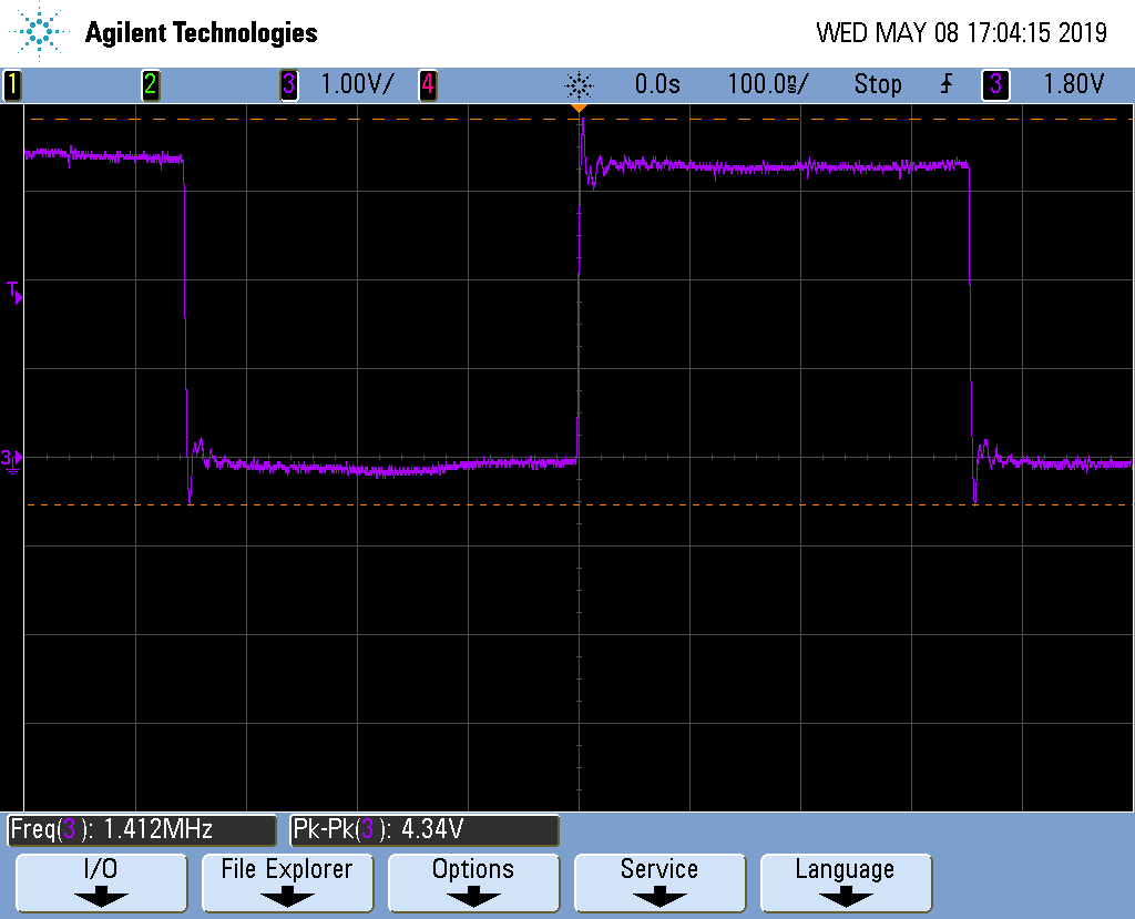

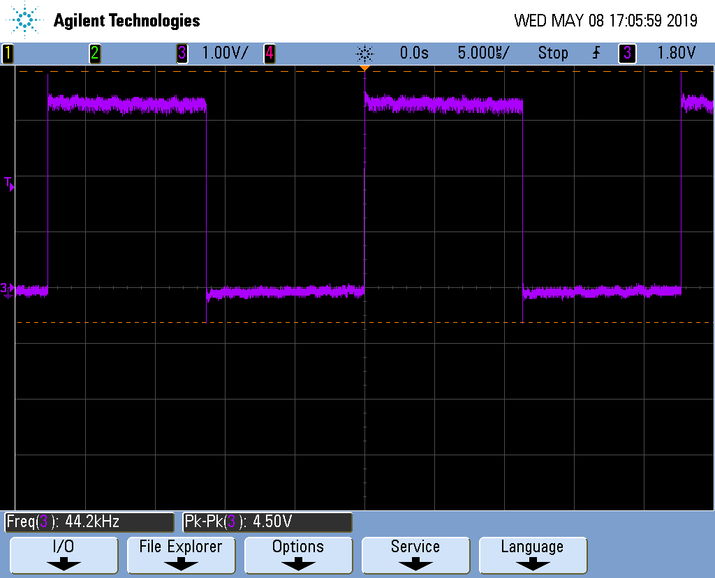

  • Here are the oscilloscope screen captures for the pins above:
    Master Clock (HDMI_AUDMCLK) - 12 MHz
    Bit rate clock  (HDMI_AUDBCLK) - 1.412 MHz
    Frame/Word Sync Clock (HDMI_AUDFSX) - 44.2 kHz
    Audio Data - Looks like a valid data.
    Here were the problems is:
    The the frame clock is meant to be 44.1 KHz but the exact value is not possible from the internal 24 MHz oscillator. The McASP is using the 24 MHz oscillator because the 12 Mhz external oscillator is not fed to the processor McASP module.
    The bit rate clock is for two 16 bit slots (32 times the sampling rate), which is someout outdated frame.
    44.1 kHz x 32 = 1.4112 MHz, which is the measured clock and can be derived from 24 MHz - 24 MHz / 17 = 1.411 MHz
    The McASP manual says that 32 bit slots should be used even with 16 bit payload. In that case the bit clock cannot be derived with the available even dividers from 24 MHz.
    The measured bit rate clock and frame sync would have worked in this case but the 12 MHz master clock is not correct. The SiI9022A part requires (quoted from the datasheet):
    "A separate master clock signal that is coherent with the I2S inputs is required for HDMI time-stamping purposes. Coherent means that this clock signal and the I2S inputs must have been created from the same clock source."
    In addition, there are specific frequencies required and for the 44.1 KHz :
    The provided 12 MHz clock is neither coherent nor any of the frequencies in the 44.1 kHz column.
