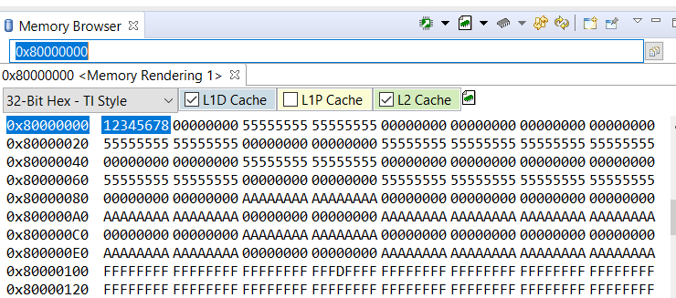

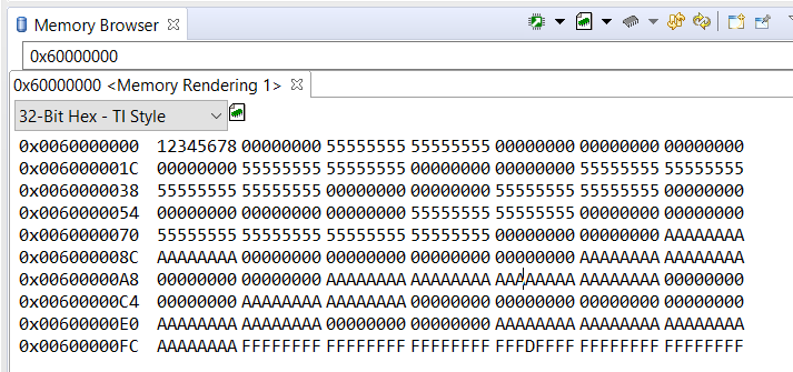

    2. Connect DSP core 0, it has default MPAX setting, mapping DDR3A 2GB from physical 0x0:8000_0000 to logical 0x8000:0000
    0x08000000 000000BF 0000001E 800000BF 8000001E 121010FF 2101000B 00C400FF 0C400014
    3. Now I changed the MPAX pair 1 to mapping DDR3B 512MB from physical 0x0:6000_0000 to logical 0x8000:0000
    0x08000000 000000BF 0000001E 060000BF 8000001C 121010FF 2101000B 00C400FF 0C400014
    I was able to verify that phy and logical match
    4. I wrote a simple code to put everything in DDR3B. The heap is also inside, the alloc has no issue. Project attached.
