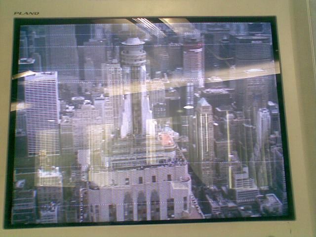

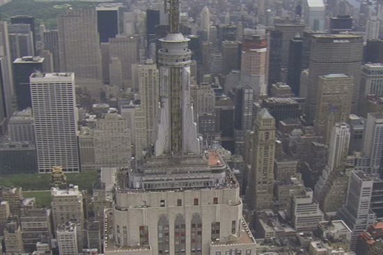

    Following are the original image (720x480) and snapshot of the display on analog TV as well as LCD dispaly.
    INPUT IMAGE:
    DISPALY ON ANALOG TV
    DISPLAY ON LCD MONITOR
    You can see that the LCD monitor is displaying more than Analog TV, but still not perfect.
    Please let me know, is there any wrong with register setting...
    Jai
