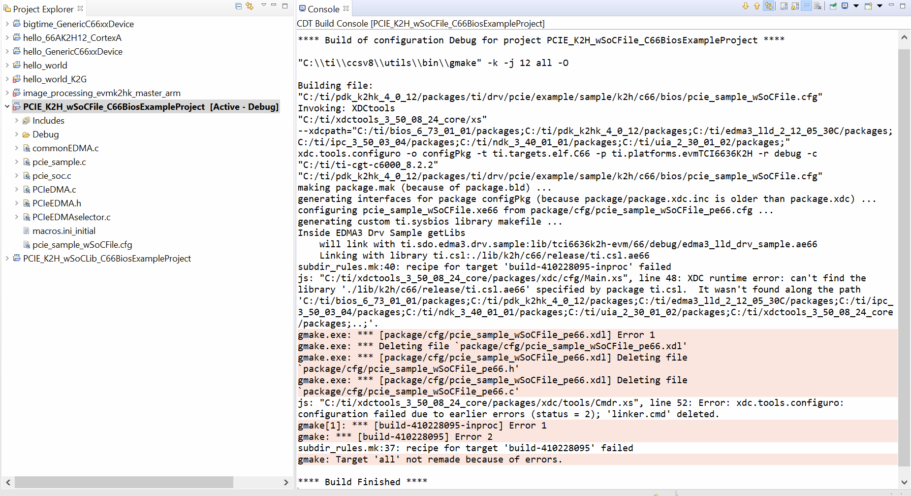

Hi all,

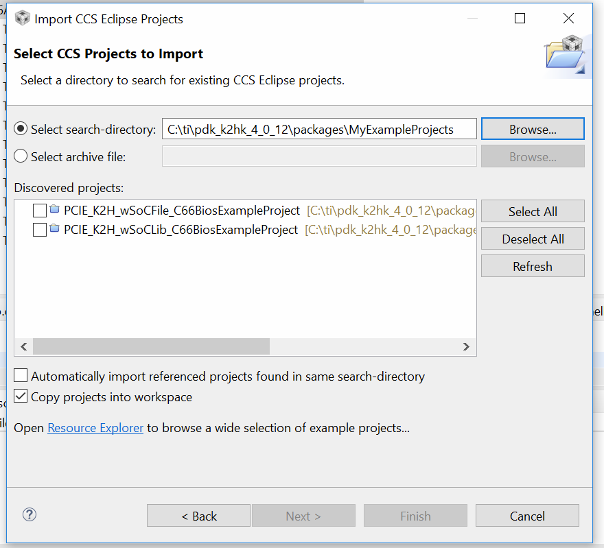

I am having trouble building the PCIe example for the K2H evaluation module. I am following the guide here: http://software-dl.ti.com/processor-sdk-rtos/esd/docs/latest/rtos/index_overview.html#building-the-sdk
The steps I have taken are as follows:
  1. From the command line I navigate to the PDK directory, and then packages.

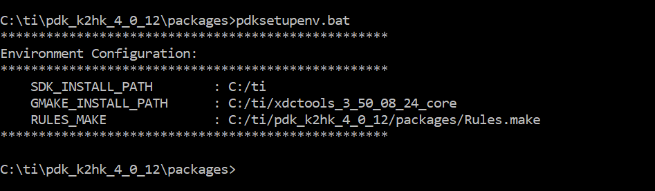

  2. Run C:\ti\pdk_k2hk_4_0_12\packages> gmake clean
  3. Run C:\ti\pdk_k2hk_4_0_12\packages> pdksetupenv.bat

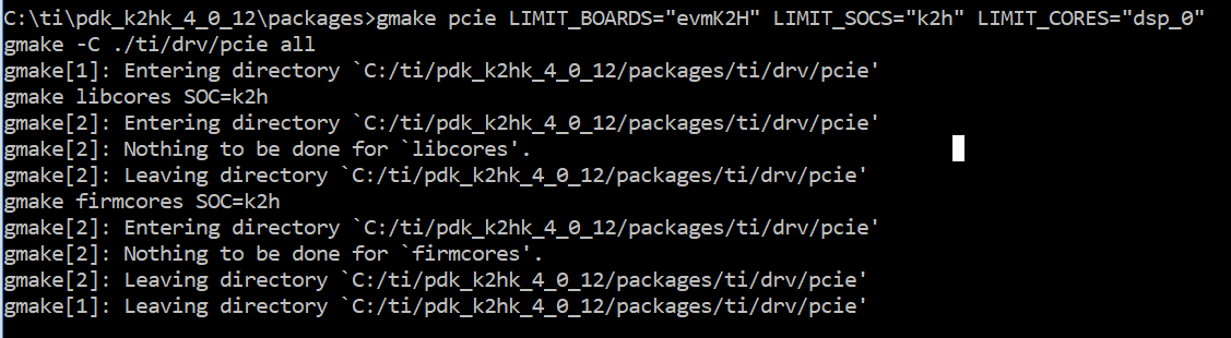

  4. Run C:\ti\pdk_k2hk_4_0_12\packages> gmake pcie LIMIT_BOARDS="evmK2H" LIMIT_SOCS="k2h" LIMIT_CORES="dsp_0"
  5. Run C:\ti\pdk_k2hk_4_0_12\packages> pdkProjectCreate.bat K2H all little pcie example dsp

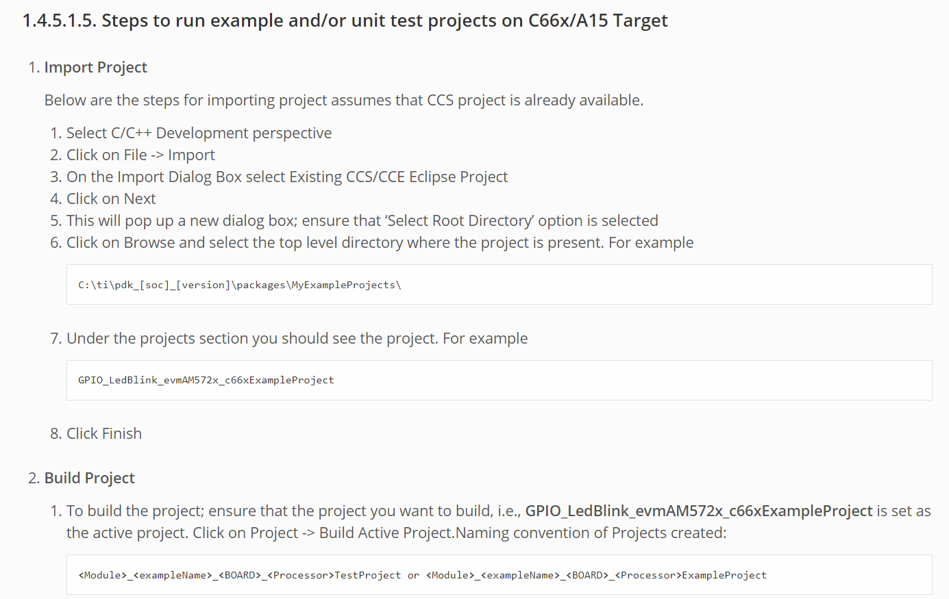

  6. Then I follow the guide from the link at the top of this post to bring the project into Code Composer Studio and then build it:
  7. And then ultimately, I build the project, as described in Step 2. And.....I get an error.
  8. I feel as though I've followed the steps in the guide word-for-word. So could anyone please explain what I'm doing wrong, and what I can do in order to get the PCIe example to build for the DSP Core 0?    Thank you,Andre
    Your error indicated that there is no ti.csl.ae66 under ti\csl\lib\k2h\c66\release, can you double check your computer folder if you have this file or not? I saw you did a "gmake clean", it is most likely you deleted all the pre-build libraries without rebuild it.

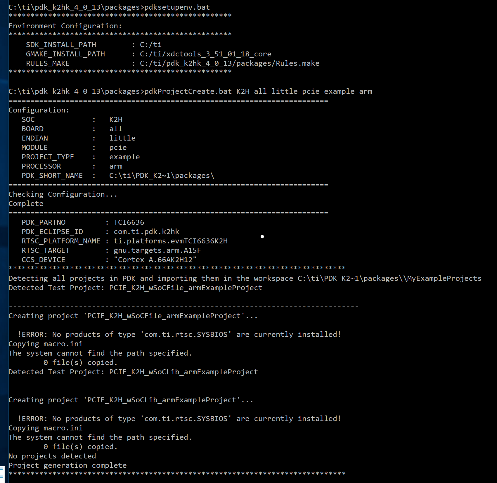

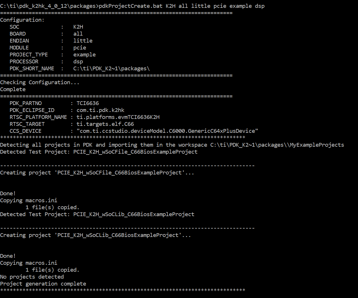

    So I re-downloaded the pdk installer, and installed it. The install appeared to work properly without an issue, and I did the pdksetupenv.bat and then the pdkProjectCreate.bat as follows:

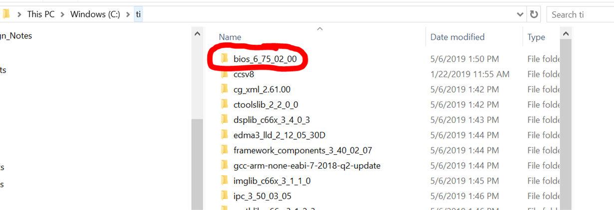

    As you can see, the project creation fails because of a lack of SYSBIOS being installed. I thought the installation may not have gone correctly so I deleted all the installed directories, and re-installed. Ran the commands in the image above again, but still the same error.
    I checked my C:\ti directory and see the bios library there.
    I tried setting the BIOS install path manually after that:
    set BIOS_INSTALL_PATH=C:\ti\bios_6_75_02_00
    Then I re-ran the pdksetupenv.bat script. But still the same error.
    Any idea what I'm doing wrong here?
    Thanks!
    Andre

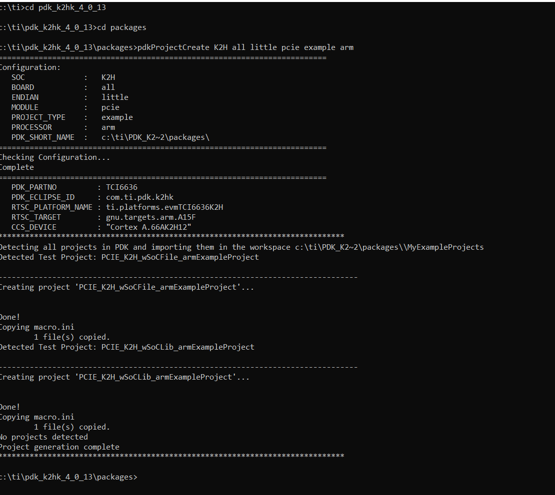

  • Eric,
    I did not do this step. Once I close and re-open Code Composer Studio, and then re-run the pdkProjectCreate.bat script as before, that error about SYSBIOS disappears. However, now there is an error about no XDCtools being installed. I checked the install directory and there is the correct version of XDCTools installed there at the default location: C:\ti\xdctools_3_51_01_18_core
    C:\ti\pdk_k2hk_4_0_13\packages>pdkProjectCreate.bat K2H all little pcie example arm
    Configuration:
       SOC             :   K2H
       BOARD           :   all
       ENDIAN          :   little
       MODULE          :   pcie
       PROJECT_TYPE    :   example
       PROCESSOR       :   arm
       PDK_SHORT_NAME  :   C:\ti\PDK_K2~1\packages\
    Checking Configuration...
    Complete
       PDK_PARTNO         : TCI6636
       PDK_ECLIPSE_ID     : com.ti.pdk.k2hk
       RTSC_PLATFORM_NAME : ti.platforms.evmTCI6636K2H
       RTSC_TARGET        : gnu.targets.arm.A15F
       CCS_DEVICE         : "Cortex A.66AK2H12"
    Detecting all projects in PDK and importing them in the workspace C:\ti\PDK_K2~1\packages\\MyExampleProjects
    Detected Test Project: PCIE_K2H_wSoCFile_armExampleProject
    Creating project 'PCIE_K2H_wSoCFile_armExampleProject'...
      !ERROR: No XDCtools are currently installed!
    Copying macro.ini
    The system cannot find the path specified.
            0 file(s) copied.
    Detected Test Project: PCIE_K2H_wSoCLib_armExampleProject
    Creating project 'PCIE_K2H_wSoCLib_armExampleProject'...
    Copying macro.ini
            0 file(s) copied.
    No projects detected
    Project generation complete
    Any ideas here?
    I went ahead and ran the pdksetupenv.bat script before running the project create script. I also tried the alternative commands (as mentioned in the guide here: http://software-dl.ti.com/processor-sdk-rtos/esd/docs/latest/rtos/index_overview.html#building-pdk-using-gmake-in-windows-environment
    set RULES_MAKE = C:/ti/pdk_k2hk_4_0_13/packages/Rules.make
    set PATH=%PATH%;C:/ti/xdctools_3_51_01_18_core
    Still the same XDCTools error. Any ideas?
    Thanks so much for your help and for being so responsive. Again, it's much appreciated!
    - Andre

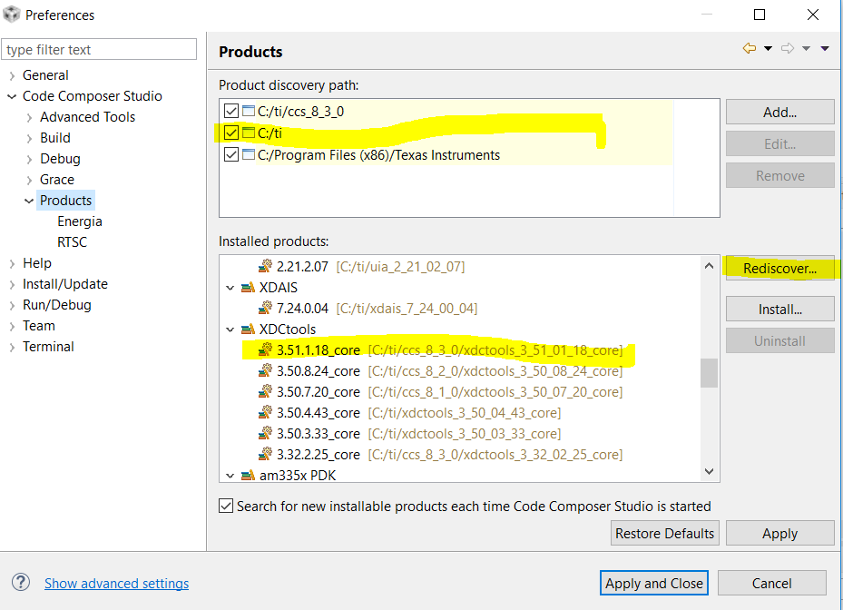

  • Andre,
    No problem. I assumed you installed PDK and CCS under the default location c:\ti
    - Run CCS 8.3, in Window---->Preferences (see below). do you see xdctools_3_51_01_18_core detected and registered by CCS:
    If not, you can click the "rediscover" to re-scan and add it to CCS.
    - Look at pdkprojectcreate.bat, make sure it looks for:
    REM Version of XDC
    set XDC_VERSION=3.51.01.18
    - If you installed CCS some place else, modify this:
    if not defined CCS_INSTALL_PATH (
    set CCS_INSTALL_PATH=C:/ti/ccs_8_3_0/ccsv8 ============> for me, I installed in a different location.
    - You don't need to run "pdksetupenv.bat", no need
    It worked for me:
    Regards, Eric
