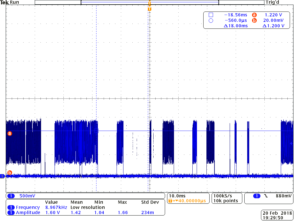

We've had a design in the field for 3 years that exhibits a 'slow' boot condition during which normal execution occurs at maybe 1/20 of the expected speed.  It occurs on less than 1/10 of a percent of fielded units.  It's slow enough where the WDT fires and creates a WDT reset event.  However, the slow boot condition continues and the cycle repeats.. forever, until POR.  Our work around has been to check the reset reason in u-boot and issue a reset from the PMIC if the reset reason is WDT.  This resolves the issue and the device is able to boot normally after initially failing.  However,  the over all boot time is creating problems and we need to understand why this is occurring and what more can be done to avoid the situation, what is root cause?  In one unit that that we've been able to capture the condition it seems to be related to CKE on the SDRAM.  During a normal boot CKE show continuous clocking, however in the 'slow boot' condition CKE operates in a busting manner.  See below.  This design was reviewed 3 years ago by TI and a Hyperlynx simulation was performed on the SDRAM to ensure proper timing.  This issue doesn't seem to be related to any environmental condition or any unusual electrical condition such as EMI or ESD.
    The first thought that comes to mind based on your description is that perhaps the PLL has not properly locked.  If you were in bypass mode then you might experience this sort of issue.  Something like that might happen if there's excessive noise on the VDDS_PLL_* rails.
    How much time is this workaround adding?  I would have expected it to be very small, e.g. <1sec.  What is your boot time requirement?

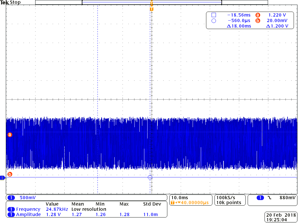

  • Can you verify that it is CKE that is toggling? CKE should not be toggling like that. It should only go low when you intend to go into self-refresh for low power, otherwise it should stay high.
    Do you know when you are executing slow? For example, is the ROM executing slowly, or only after your bootloader has executed? Or only when executing out of DDR?
    If you have JTAG access (not sure if you do since it is in a product), we can help you narrow down where the problem is. There are a couple of scripts to run via JTAG that can help find configuration issues.
    Brad's idea is a good one. You can check lock of the ARM PLL using register CM_IDLEST_DPLL_MPU (0x 44E0_0420)
    James
  • Yes, it is DDR_CKE Ball G3 on the ZCZ package that is toggling.  The only indication that we know we're running in 'slow mode' is the rate at which messages are produced on the console and the activation of the WDT reset, which, oddly fails to restore normal operation.  We typically use reset reason == WDT to indicate that we should issue a PMIC reset to recover,  This is known be be effective.  We're currently using u-boot as our boot loader which checks to ensure the PLL is locked prior to continuing the boot process and this appears to be working.  If the PLL fails to lock uboot will hang until WDT resets, but, what we see is messages continue to be output on the serial port.  Our JTAG port is available, what scripts can you suggest we try to verify configuration?
    Jim

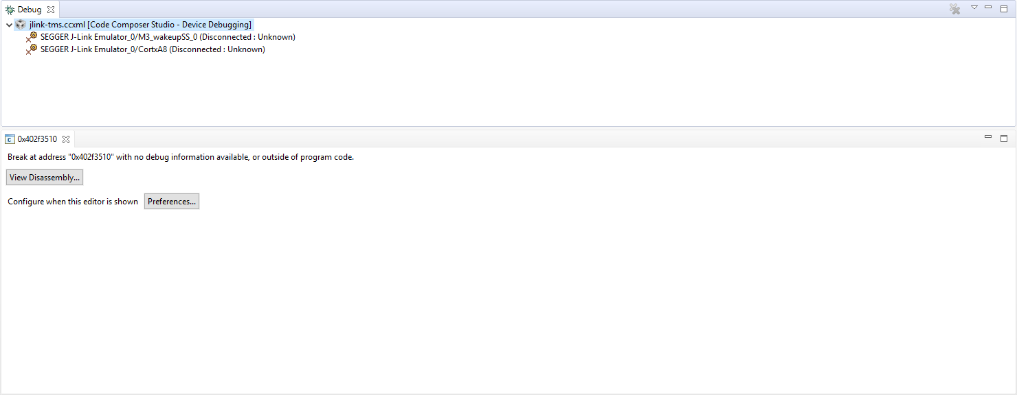

  • Hi Brad, I work with James and am trying to make this work. I have a Segger JLink connected to our device. It can connect just fine on its own using JLink Commander:

    This took a couple of tries (I deleted the first connect failure lines as irrelevant).
    Then, following the instructions in the README, CCS says this in its Debug tab:
    As per the instructions, I did NOT try to connect to the unit in any way (after I saw that the JTAG was working all the way through to the target, I disconnected and re-connected it physically and then re-invoked CCS to get the above screen shot.) But, when trying to execute the script as per the README instructions, I get this:
    js:> loadJSFile c:\workspace\am335x-dss-files\am335x-boot.dss
    Could not open session. No matching devices found. (c:\workspace\am335x-dss-files\am335x-boot.dss#60)
    js:>
    Does #60 mean "line 60" in that file?
    Line 60 is this:
    debugSessionDAP = ds.openSession("*","CS_DAP_DebugSS");
    Thanks in advance.
  • Looks like your Segger can connect to the Cortex A8 but not the DAP. The scripts all use the DAP since it avoids the MMU. Do you have any TI XDS debuggers? If not you might consider getting an XDS110 for this purpose. It is only $99.
    You might be able to make the script work by changing CS_DAP_DebugSS to CortxA8.  If the MMU is not yet enabled that will work ok. Once Linux enables that won't work.
  • finally got it to run and produce results by changing all places referencing _DAP_ to CortxA8. It seems to be impossible to simply attach files to this message as it inserts them into the message itself, so I must cut and paste the text from these here, in order.

    As a sanity check, your device boots from 8-bit NAND right?
    Are you sure CKE is toggling? Normally you would see that toggling to indicate the DDR entering/exiting self-refresh mode. However, I wouldn't expect that to happen at all while the board is booting.
    Do you have an EMIF spreadsheet that you filled out that you can attach?

    I think for starters you should check to see if adding in code to u-boot that forces that to a defined value (either 0 or 0xA0) fixes the issue.  In other words, before we get overly obsessed with this register, it would be good to have some further confirmation that this truly has a big impact on the issue.  I think it will, but let's verify.
    The next question in my mind would be WHEN is this register taking on this value of 0x2A0.  You might need to add some additional prints into u-boot and/or Linux to understand that one.  Given that this issue happens "after some time", I expect it's happening in Linux, and then never getting cleared out by u-boot.  So I think having u-boot initialize this register is good.

  • Stephen Biggs said:
    Missing a post that got sent to moderation where I questioned the validity of your script flagging an errata issue with the EMIF register when we weren't doing self refresh.
    It's true that it's only an actual issue when you actually enable self-refresh.  There are a lot of different software environments, and in some cases this PWR_MGMT_CTRL register may be changed using a read-modify-write that expects the proper timing to already be there and is only switching between self-refresh and normal mode.  It's best to just have it configured appropriately all of the time.
    I would think this register would be set to a known value during reset, but perhaps this isn't happening because it's persistent through software watchdog reset.  Is this a possibility?
    It certainly seems that this EMIF_PWR_MGMT register is persistent through a watchdog reset.  Take a look in the Technical Reference Manual at Table 8-26. Reset Sources.  The watchdog reset does not reset the PLL's and also puts the DDR into self-refresh.  A cold reset on the other hand will reset everything.

    Yes, a POR will clear this register.  However, ensuring the DDR initialization code writes to this register (which is what is done in the current u-boot) is something you should be doing.
  • I'm looking in the Technical Reference manual rev P table 8-26 and I see where the PLLs are reset differently but you mention that watchdog reset puts the DDR into self refresh.  I don't see that in the table, where is this indicated?  I'm also looking where EMIF_PWR_MGMT is persistent though watchdog reset and I'm not seeing that, can you help oint that register out for me?  Thanks
  • Hi James, it is mentioned in figures 8-22 and 8-23 (Rev O of the TRM). This is admittedly subtle, but the point is that any warm reset (which includes watchdog reset), will put the DDR into self-refresh. As a consequence, the DDR controller and PHY will maintain its configuration so that it can successfully exit from self-refresh.
    As stated earlier, if you don't ever intend to use power management, then PWR_MGMT register should always remain 0x0. Whenever you have it set to 0x2A0, the EMIF will put the DDR into self refresh after a certain amount of idle time (sr_tim clock cycles). This can be good in some use cases, but for your case, going in and out of self-refresh multiple times (which is why the CKE signal was toggling) seems to be causing too much overhead and slowing down execution.
    With no intention of power management, CKE signal should remain high all the time.

  • Hi James, self-refresh should be entered on any warm reset. You should see CKE signal go low indicating self refresh. And the DDR configuration registers maintain their state.
    I experimented with this a little on our EVM, and the PWR_MGMT register will be loaded with the value of PWR_MGMT_SHDW after a warm reset.
    It seems like everytime you boot, the PWR_MGMT and PWR_MGMT_SHDW register aren't consistent. Maybe that's why you are seeing different results?
    James
