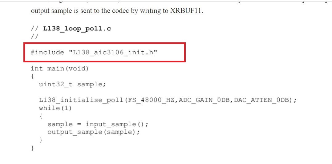

Respected Fellows,
                             I am Using Evm Omap-L137 Starter Kit. I am having difficulties with Initializing Codec. I just want to start with simple non-software example. i would like to feed in Analog Signal (at LINE IN PIN ) and wanted to see on Oscilloscope (Through Line Out pin of Omap-l137). Its just a simple Analog to Digital And Digital to Analog conversion.I found out 3 ways for doing this task (1.Polling 2. Interrupts 3.DMA ). I would like to use Polling method. I am consulting a book which is on OMAP-L138. Because there is not much help available for OMAP-L137 that is why i am consulting book on OMAP-L138 .Both sharing same codec AIC3106. I am sharing program which i would like to implement. but i am note share where is this header file "L138_aic3106_init.h". Do anyone have idea how to make this file?or any related example or way of doing this.
    I did some searching and I think that header files comes with the Digital Signal Processing book you are referencing. I could not find it in any of our current or older software packages.
    For help on initializing the codec, I recommend taking a look at our McASP driver in Processor SDK. There is source code on the codec including initialization  which can be found at ~\pdk_omapl137_x_x_x\packages\ti\drv\mcasp\example\src\aic3106_if.c. I've attached it to this post as well.
