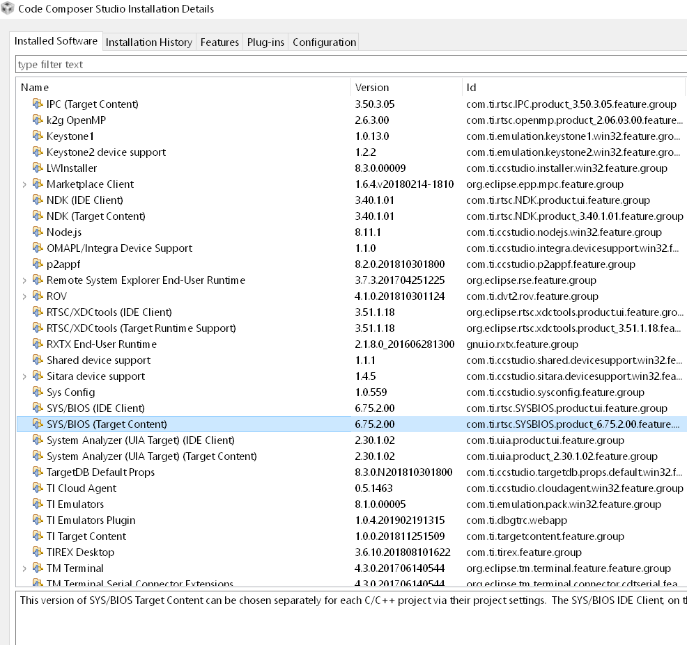

I am using an Ubuntu 18 LTS laptop to develop for an AM572X Industial development kit.
I have installed ti-proessor-sdk-RTOS-am57xx-evm-05.03.00.07-linux-x86-install, ti-processor-sdk-linux-rt-am57xx-evm-linux-rt-am57xx-evm-05.03.00.07-linux-x86.
When I navicaged to the <home>/ti/pdk_am57xx_1_0_14/packages/ and run pdkProjectCreate.sh I get an error message
Creating project 'XXX'...
!ERROR: No projects of type 'com.ti.rtsc.SYSBOPS' are curreing inatalled!
When I check in <home>/ti I have the folder bios_6_75_02_00 and code composer 9 can find the sysbios 6.75.2.
I have tried reinstalling the downloaded packages and running the setup environment scripts.  I am not sure what my next troubleshooting steps should be.

  • Bryan,
    As Chester indicated current SDK version that you are using is system tested using CCSv8.3 so we definitely would recommend that you use the version that we have specified in the Release notes so there is
    From the log, the project name XXX concerns me. Also, the eclipse package name should be com.ti.rtsc.SYSBIOS and not com.ti.rtsc.SYSBOPS.which makes me think that this is an issue with eclipse content detected on your Linux machine that is causing this issue.
    If you have completed the CCS Discovery step then can you go to Help-> About Code Composer studio and click on "Installation details" and provide a screenshot of the components specifically SYSBIOS and ID detected in CCS
     Generally the user experience with creating project should look like this:
    https://www.youtube.com/watch?v=rwXThPZmxvE
    Rahul
  • Thank you very much.  I was able to build the project changing the /ti/ccs8 to /ti/ccs901/ccs
    Was there a specific script that was supposed to be run to set the CCS_INSTALL_PATH?  I'm wondering if I forgot to run a script.
  • OK thank you. I will install CCSV8.3, that was a typo on my end.  It is installed to the correct folder.
