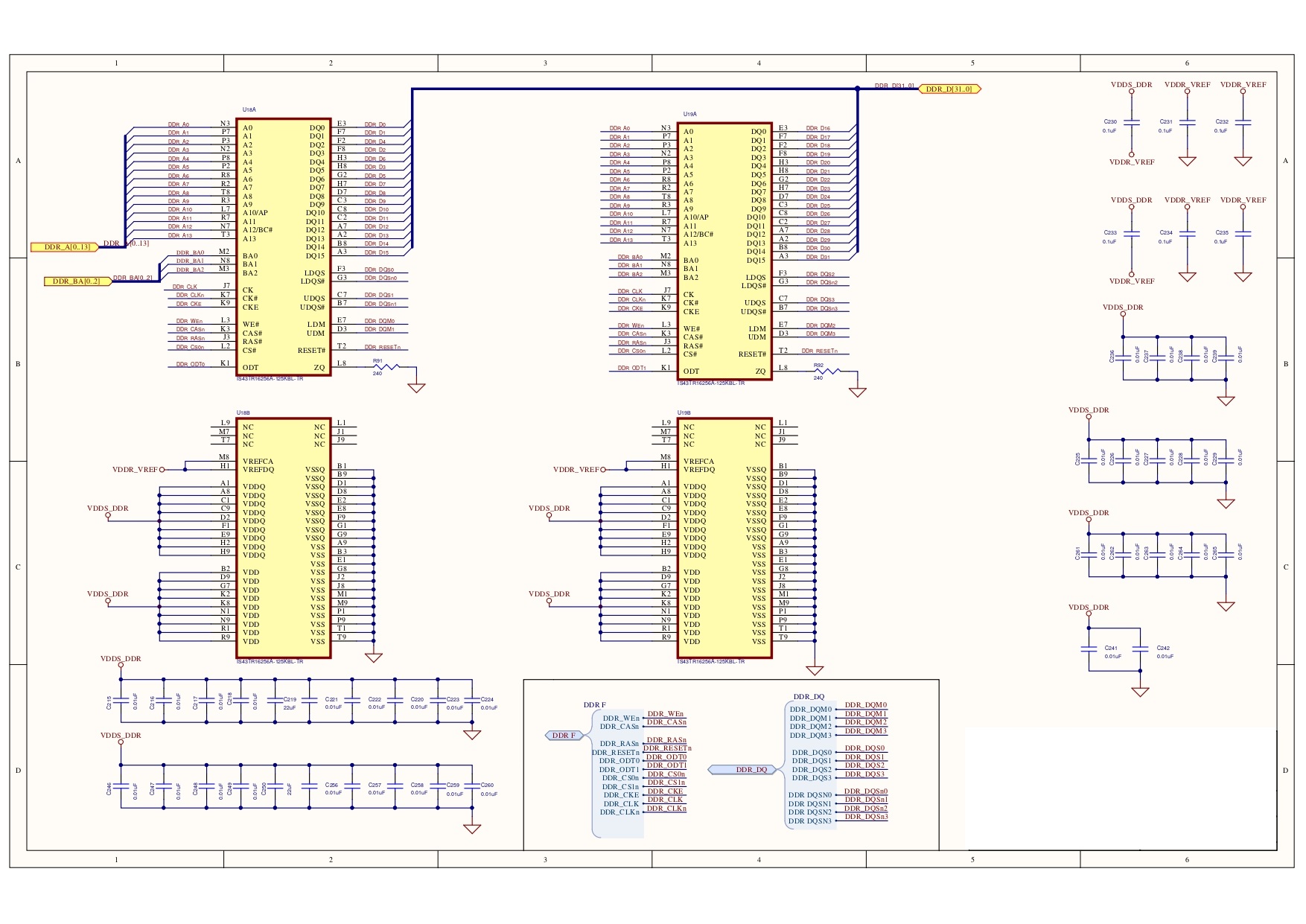

Hi ,
We developed AM5718 based SOM, and we using IS43TR16256A-125KBL-TR  2X RAM chip
I configured DDR3 memory using this EMIF tool in that spread sheet unable to change "Detail 1" value after filling remaining cell  I am getting the following output.

Question is where can i apply all this values in source code?

    I am using EMIF_RegisterConfiguration.xlsm v2.0.2 (sprac36c.zip) and PSDK "ti-processor-sdk-linux-am57xx-evm-05.03.00.07" and I am using ubuntu 16.04 HOST
    Ravi
    Based on the new values, please update the file "board.c" in the directory <u-boot>/board/ti/am57xx. As a reference, in uboot, please look at commit ids "d7b39ec7cd2ea0ee64ed7e3551246e495e4fc4a6" and "209742fa8858a201af2f32e05b1fb72ef299540e".
    Krunal
  • Hi Krunal,
    I updated "board.c" file in  <u-boot>/board/ti/am57xx. After update uboot-spl not booting
    Then i found out issue with ".dmm_lisa_map_3 = 0xFF020100"
    Later i changed to ".dmm_lisa_map_3 = 0x80640100"  uboot-spl start booting and stopped in "image entry point: 0x80800000", I attached uboot-spl log for your reference
    We use this  IS43TR16256A-125KBL-TR  RAM chip in our design,and i attached EMIF_RegisterConfiguration spread sheet with updated values for your reference.
    Our RAM memory schematic based on this
    Ravi
    5661.am5718_som_uboot-spl.logEMIF_RegisterConfiguration.xlsm.zip

    In mean while we did the hardware review and found an address bit A14 not connected to DDR memory.And I want to know, any possibilities to configure RAM for 512MB and make u-boot work.
    For this I need an expert's advice,so that I can tell the same to my hardware team.
    Could you please help.

  • Ravi, i still see discrepancies in a lot of the EXT_PHY_CONTROL registers between the spreadsheet and the DSS script. Below is just an example:
    EMIF_EXT_PHY_CONTROL_2 = 0x07000071
    EMIF_EXT_PHY_CONTROL_3 = 0x07000086
    EMIF_EXT_PHY_CONTROL_4 = 0x07000088
    EMIF_EXT_PHY_CONTROL_5 = 0x07000090
    EMIF_EXT_PHY_CONTROL_6 = 0x07000700
    0x006B0094, // EMIF1_EXT_PHY_CTRL_2
    0x006B008F, // EMIF1_EXT_PHY_CTRL_3
    0x006B0088, // EMIF1_EXT_PHY_CTRL_4
    0x006B0082, // EMIF1_EXT_PHY_CTRL_5
    0x006B006B, // EMIF1_EXT_PHY_CTRL_6
    Please ensure all of these values (check all 36 register values) get copied over into your source code.
    James
  • Hi James,
    Those values changed frequently, we checked on both AM5718-IDK as well as our custom board
    Pleas find the attachment in that you can find same value in both EMIF tool spreadsheet and board.c
    Ravi
    AM5718_DDR_CONFIG_TEST_22May2019.zip
  • Hi James,
    We are  looking forward for your replay.
    Ravi
    8741.AM5718_DDR_CONFIG_TEST_22May2019.zip
  • Hi James,
    We try to do debugging  uboot from CCS,u-boot-spl loaded and executed successfully.
    Then we try to load u-boot, for this we get following error
    CortexA15_0: File Loader: Verification failed: Values at address 0x80800000 do not match Please verify target memory and memory map.
    CortexA15_0: GEL: File: /home/firmware/ti-processor-sdk-linux-am57xx-evm-05.03.00.07/board-support/u-boot-2018.01+gitAUTOINC+313dcd69c2-g825ac6e1ac/u-boot: a data verification error occurred, file load failed.
    CortexA15_0: Unable to terminate memory download: NULL buffer pointer at 0x3aa4 (Emulation package 8.1.0.00007)
    We updated "AM571x_ddr_config.gel"  with respect  to our EMIF spreadsheet registers value but in "LISA_MAP" we didn't change because it look vise versa.
    I attached our EMIF spreadsheet and gel file for your reference
    Ravi
    AM5718_DDR_CONFG_GEL_FILE_22May19.zip
  • Hi Ravi,
    Could you please explain what you mean by values frequently changing?
    Krunal
  • We do the testing for multiple times and we noticed some of the "EMIF_EXT_PHY_CONTROL_*" are changing every time we run this "am57xx-ddr.dss" script.
    Same behaviour observed in both AM5718-IDK and Custom board.
    Ravi
  • Ravi, the EMIF_EXT_PHY_CONTROL_* registers should not be changing on successive runs of the DSS script. This may be the root of your problem. The EMIF_EXT_PHY_STATUS_* registers may change. Can you post successive runs of the DSS script.
    James
  • Hi James,
    Even though EMIF_EXT_PHY_CONTROL_* registers change in AM5718-IDK it's working fine, u-boot booted successfully.
    What is the cause of change value in EMIF registers and  can you please guide us how to make EMIF_EXT_PHY_CONTROL_* registers static.
    In the mean time I will try to check all EMIF registers value via JTAG.
    We are looking forward for your replay ASAP.
    Ravi
  • Ravi, the EXT_PHY_CONTROL registers can only change with software writes. So after your board fails to boot, those values should be consistent with multiple runs of the DSS script. Please post successive runs of the script after a failure.
    James
  • Hi james,
    We found A14 is root cause for this issue,we replace with 256MB RAM chip now we got u-boot console.
    Thanks for your support.
    Ravi
