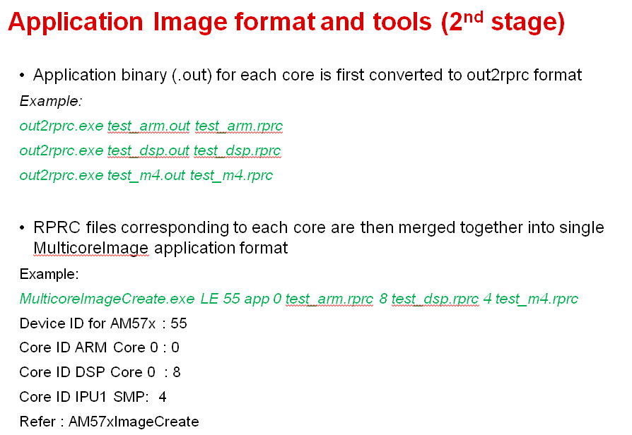

Hi everybody,
I would like to enable onboard DSP , please  coudl you redirect me to a proper example and info on :
  1. How can I modify the MLO or the A15’s code to “wake up” the DSP ?
  2. How do I compile both A15 and C66xx projects into one APP file ?
thank you
best regards
Carlo

  • Carlo,
    Steps provided by Rex Applies to users who are using ARM Linux and RTOS On the DSP. BAsed on previous interaction with you and your customer, it appears that they are using TI RTOS on both  ARM and DSP and using SBL and not  uboot/Linux. Please confirm.
    If this is RTOS -RTOS , then we have  covered this topic in the Software Developers guide as part of secondary bootloader  documentation.  There is no modification required to RTOS SBL to wake up DSP as it has mechanism to detect DSP image and wake up the core based on application binary.
    The ARM, DSP and M4 images can be merged into a single image using tool called MulticoreImageGen that we provide as part of the boot package. This topic was covered in detail in the AM57x boot slides that I had provided to you and your customer last year. I am providing a screenshot  for reference:
