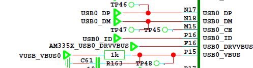

Dear TI Team,
On our custom board, we are using a usb hub(CY7C65632) connected to our USB0 interface. In order to install sw to our empty board,  we first installed u-boot-spl and u-boot over uart0,  then tried to install remained files over usb hub(on board).  But unfortunately, even if we typed "usb start" command on console, the hub is not detected by SoC. We checked usb0_drvbus first and have seen that it is not driven. To be able to test it we plugged a mouse to one of hub downstream port, then, observe the power light is lightened for a short period of time and then switched off immediately.
Pls. note that we are powering USB Hub as bus powered mode. Can you pls. suggest us what can be wrong about system?

    Thanks for the reply. But we have checked the steps and everything seems ok. If it is possible , can you pls. have a look our schematic? BTW, how can i share it with you?
  • You can post the USB portion of the schematic here.
  • Hi Biser,

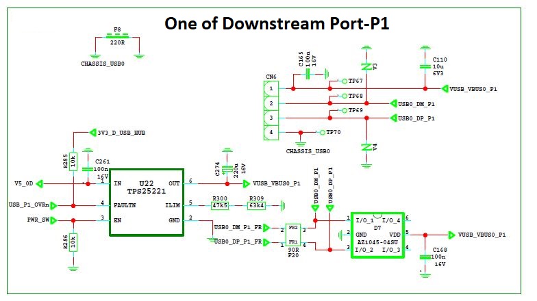

    You can find the USB related parts in below:
  • What is the VUSB_VBUS0 voltage?
  • Since AM335x_USB0_DRVBUS is driven low, VUSB_VBUS0 is at 0V.

    The schematics you provided is not complete. Please ensure
    - AM335x USB0_VBUS pin is connected to the output of the power switch VUSB_VBUS0_P1;
    - 1KOhm on USB0_VBUS pin is probably too much, please remove it;
    - AM335x USB0_ID pin should be directly grounded.
