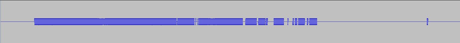

Greetings,
I've been working with the EDMA for sometime now with some success.  Implementing the EDMA with the Cache has become a significant problem however particularly on the RX buffers of the EDMA.
Currently I've been using the CSLR Cache library which has worked well for significantly speeding up many routines when receiving data through the EDMA and have experienced no problem when receiving data via the EDMA and initializing the cache prior. When transitioning to the transmit routine, it seems as though despite my output buffers being correct, the EDMA is dropping sometimes hundreds of samples, and sometimes cutting data off at the end of the routine.  It seems to be caused by the Cache routine and works fine when the cache is not enabled.  However, the cache is necessary and I'd rather not write my own code that moves my necessary code back and fourth out of L2 and L1 memory and would rather use and already developed cache routine.
I've read through the cache user manual on the TMS320C674x processors about coherence with the EDMA.  Although, more easily I feel as though it would be more ideal to place the output TX Buffers for the EDMA in a noncacheable portion of memory (Which I've tried by using Pragma statements but couldn't figure out how to change what level of SDRAM is Cachable)
Here is the code I use to initialize the Cache:

Can someone tell me what is wrong with this cache routine or point me to one that is effective from some kind of TI software?
    Can you let me know which software package you are currently using? Processor SDK? StarterWare? And is this a bare-metal or TI-RTOS application?
    Based on your response I'll look for an example that you can reference.
    Sahin
  • Sahin,
    For the EDMA-MCASP I'm using the StarterWare. I found the CSLR code somewhere, but that code along with a CSLR.h and CSLR_CACHE.h code was also supplied to make my code run more efficiently. This is a bare-metal application.  The example on the starterware only seems to address cache utilization with the EDMA for the UART.  I may just start working on trying to adapt that code to suite for now.  I've attached the two cache ".h" files.

  • Thank you Sahin,
    What you have posted has been very helpful and I've gone about implementing the cache in this manner.  However, my problems still lingers.
    I've checked to ensure my UART interrupt isn't somehow becoming an issue.  Here is the output from my DSP that I am getting when transmitting a simple Sine Wave.  It should be one full buffer length but it is not.  The frame drops are sometimes repetitive but sometimes random.  All of my tx buffers still look good and I've implemented the EDMA using a triple buffer technique so there should be no issue there either.  Seems like there could be a setting issue somewhere but not sure what it could be as this has not been a problem in the past when implementing with an EDMA.
    I've even tried stopping the code to prevent anything from being written into the buffers while the EDMA is transferring to MCASP and I still experience this same error.
    Tyler
