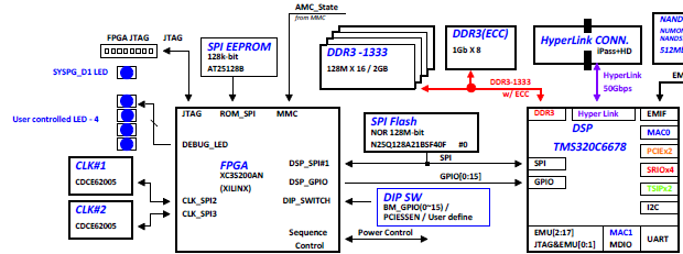

I am trying to read data from an external FPGA which is interfaced with a ADC. I am using evmc66x_spi.c (Processor SDK 5.2) for calling SPI routines. I have pasted my main code below. I have initialized the SPI core (for CS1 ). In this code I am trying to read 16 bit data from FPGA (initialized as Slave). I am using infinite for loop so that I can continuously receive data from FPGA. When I run the code, the status flag in the FPGA get high but the C6678 does not read any values in the buffer and when I pause the code anytime, it is stuck at this while loop (line 42 in below code) in spi_xfer() function in evmc66x_spi.c file.

  • Harshu,
    Please let us know if you are seeing the chip select go low and clock on the SPI pins when you run the code. Is there a reason why you have chosen to use platform library  instead of the SPI LLD driver.
    Also please indicate how you have connected the external FPGA and ADC to the SOC given the base EVM has the following SPI  configuration to connect to FPGA/flash.
    Rahul
  • I am not able to see any wave on clock and chip select was always high. I actually tried using the SPI driver functions. I tried to use the SPI example project which reads data from flash through SPI, but it was also not working.
    Actually, the ADC is interfaced with the external FPGA  DE0-nano ( used as a buffer), and then the FPGA is connected as slave to the SPI master of DSP board which is configured for 1 MHz clock. I have attached the SPI example project main file below. If you can tell, what I am doing wrong in this SPI driver functions, it would be great help. The below code doesnot return any boardhandle due to which code is not able to go forward. I am really confused about what to use. To me, the platform library evmc66x_spi.c file functions made some sense, so I started with that. But still I am not getting any result. If you can tell, what I am doing wrong in this SPI driver functions, it would be great help.
