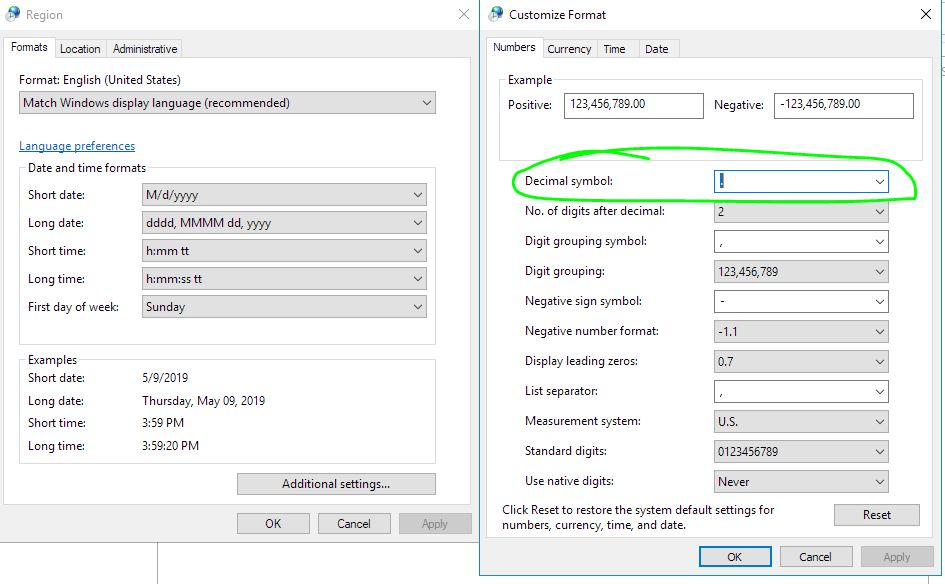

  • Hello ,
    Looks like the JVM is adoption the windows regional decimal formatting on the user machine. I.e. it interprets decimal places as commas which is messing up the arithmetic value trying to calculate integers.
    Can you make sure the PC is configured as follows (if you are using WIN10).
    1. Go to "Region and language settings"
    2. Click on "Additional date, time, & regional settings"
    3. Click on "Change date, time, or number format",
    4. Click on "Additional settings" and make sure decimal symbol is a period. Sample scrrenshot below. Restart the tool and let us know the result.
    It's an odd problem but hope this solves the issue.
    thanks,
    Alex
  • Alex,
    changing the Windows Regional format to 'English' fixes this problem and is currently used as workaround. Just selecting in the Windows number format configuration a period as 'Decimal symbol' and comma as 'Digit grouping symbol' doesn't solve the problem. Of course the preferred solution would be to get this fixed in CTT instead of always re-configuring Windows for just one program, especially as it worked without any issues in the first beta release with added 'Frequency Analyzer' tool (CTT-Automotive-v1.0.0.2).
