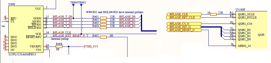

our schematic look like this
our .dtsi file look like this (no qspi references are in our .dts file), it is essential a modified copy from am57xx-idk-common.dtsi

  • You're missing pullups on D2 and D3. Best solution is to add them on your board, but for now enabling the internal pullup in u-boot mux_data.h should be sufficient.
  • We tried to add the pull up but no difference,

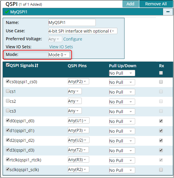

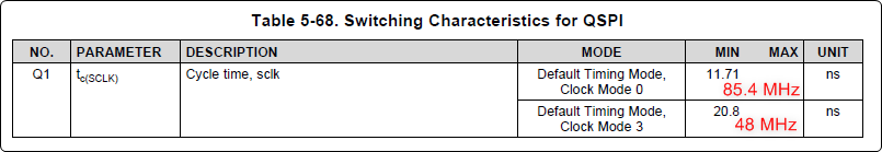

  • Stefan Thorlacius said:
    &qspi { status = "okay"; m25p80@0 { compatible = "spansion, s25fl512s", "jedec,spi-nor"; spi-max-frequency = <50000000>; reg = <0>; spi-tx-bus-width = <1>; spi-rx-bus-width = <4>; #address-cells = <1>; #size-cells = <1>; spi-cpha; spi-cpol; m25p,fast-read;
    I want to make sure you're aware of a very close relationship between the items I highlighted above and the pin muxing.  For example, here's a snippet out of the data manual:
    So as you can see, the max speed differs depending on whether you're using Mode 0 or Mode 3.  This also ties into the pin muxing, as there are different I/O modes depending on whether you're using Mode 0 or Mode 3:
    This is why the PinMux Tool needs you to specify whether you plan to use Mode 0 or Mode 3:
    You should only add spi-cpha and spi-cpol if you're using Mode 3.  If that's the case however, you must set your maximum frequency to 48 MHz and be sure that the pin muxing is configured correctly (i.e. you may need to regenerate your pin muxing and rerun the perl script).
    Brad
