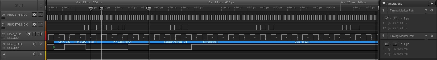

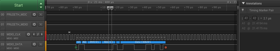

I am currently bringing up the network on our custom board largely based on the AM5728 IDK (we are using AM5726 processor). In our design, we swapped the KSZ9031RNX PHY (eth0 and eth1) for the DP83822 PHY and connected as MII. The same PHY/design was used for eth0, eth1, eth2, and eth3 (eth2 and eth3 are PRU ICSS Ethernet). The pinmux has been updated to reflect the new configuration, and is confirmed to work because I can run the NIMU Dual MAC Example project successfully. When running this app through Code Composer Debugger, both interfaces get link, are assigned IP addresses, and can be pinged from an external computer. The MDIO interface is also confirmed to be working as expected (1MHz clock). The only changes I made to the device tree to support this was to change the phy-mode from "rgmii" to "mii". With the new device tree, both PHYs are detected by MDIO (see boot console output attached) recognize link up/down when connecting/disconnecting Ethernet cables. Link status is seen both in hardware via LEDs and in the console. While they are configured for DHCP through systemd, they do not get an IP address. Setting static IP also does not work. The only way I am able to get an IP address is to run an M4 app that initializes (or maybe reinitializes) GPIO via the boardInit() function and resets the PHYs in hardware by toggling the reset pins. After running this app, both eth0 and eth1 get IP addresses. While this is technically a viable option, it is a hack and not the correct solution.
One thing that I noticed when comparing our custom board to the IDK board is that the MDIO seems to have some issues on our custom board. One issue that I am seeing is that MDC is 125kHz even though it is being set to 1MHz in the device tree. See the image below illustrating this:
In the above image, the first two signals pertain to the PRU ICSS Ethernet MDIO bus. The second two signals are for eth0 and eth1 MDIO. As you can see, MDC is at 125kHz for eth0 and eth1 but MDC for ICSS is 1MHz. Another issue I have observed is that the MDC and MDIO run in bursts. The following image is a zoomed out view of the same logic trace which shows the bursting:

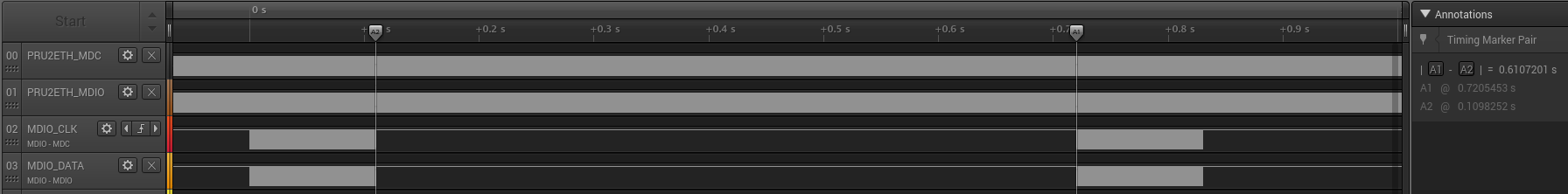

There is about 600ms between bursts in this trace, but the time between bursts changes over time (increase and decrease) and I have seen over 1 second at times. Note that this MDIO behavior is only seen when running Linux. When running the NIMU example app, MDC/MDIO functions as expected at 1MHz with no bursts. It is also worth noting that although the MDIO is not functioning as expected, the data being read/written appears to be good. It just is running at a slower rate and in bursts. This weird behavior does not go away after the M4 app is run and the interfaces get IP addresses.
One hunch that I have is that this is somehow related to initialization being done in boardInit() call in the M4 app. Is the boardInit() call does something that the bootloader does not do? Another strange thing is that the network interfaces come up as expected after a reboot. This issue only occurs after a hardware power cycle. One thing I am going to try is to try to do a loopback test in uboot. In the mean time, if anyone has suggestions for what could be happening, that would be greatly appreciated.
