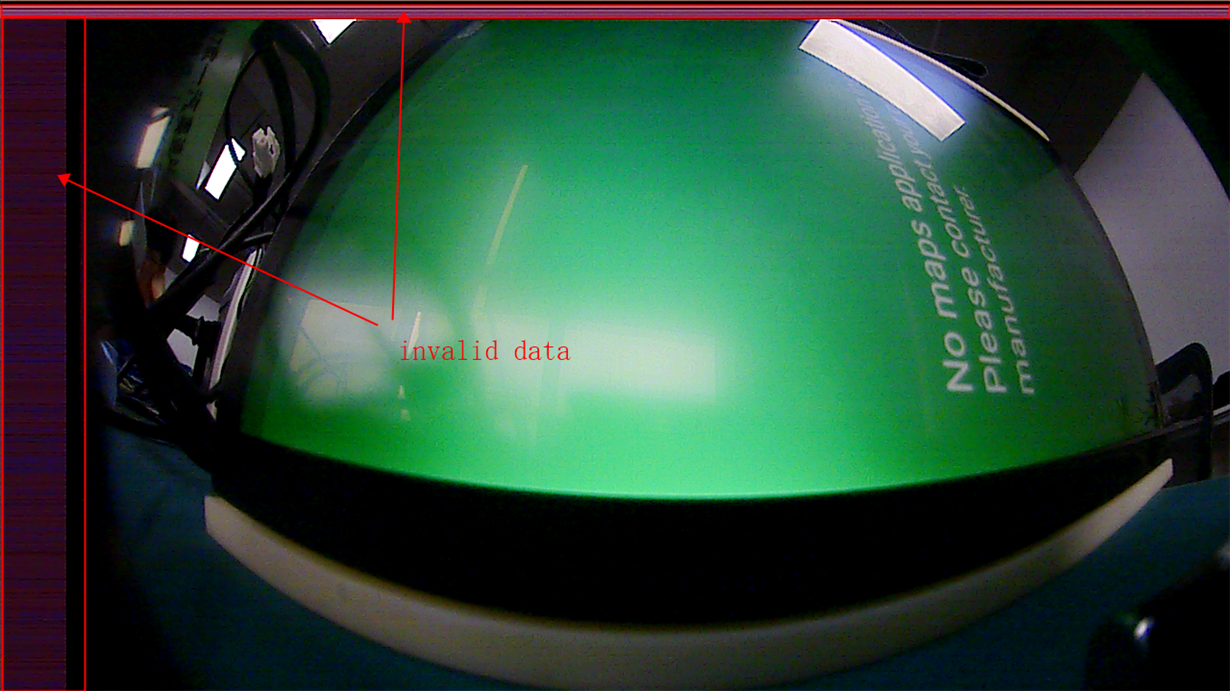

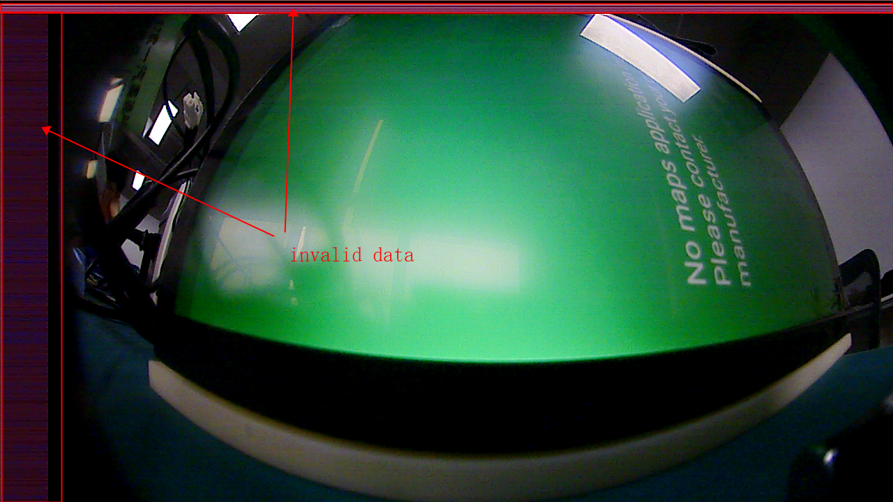

HI TI,
I use 6ao1.1 sdk,and I can capture the camera image,but the image has invalid data , i think it's blank proble.

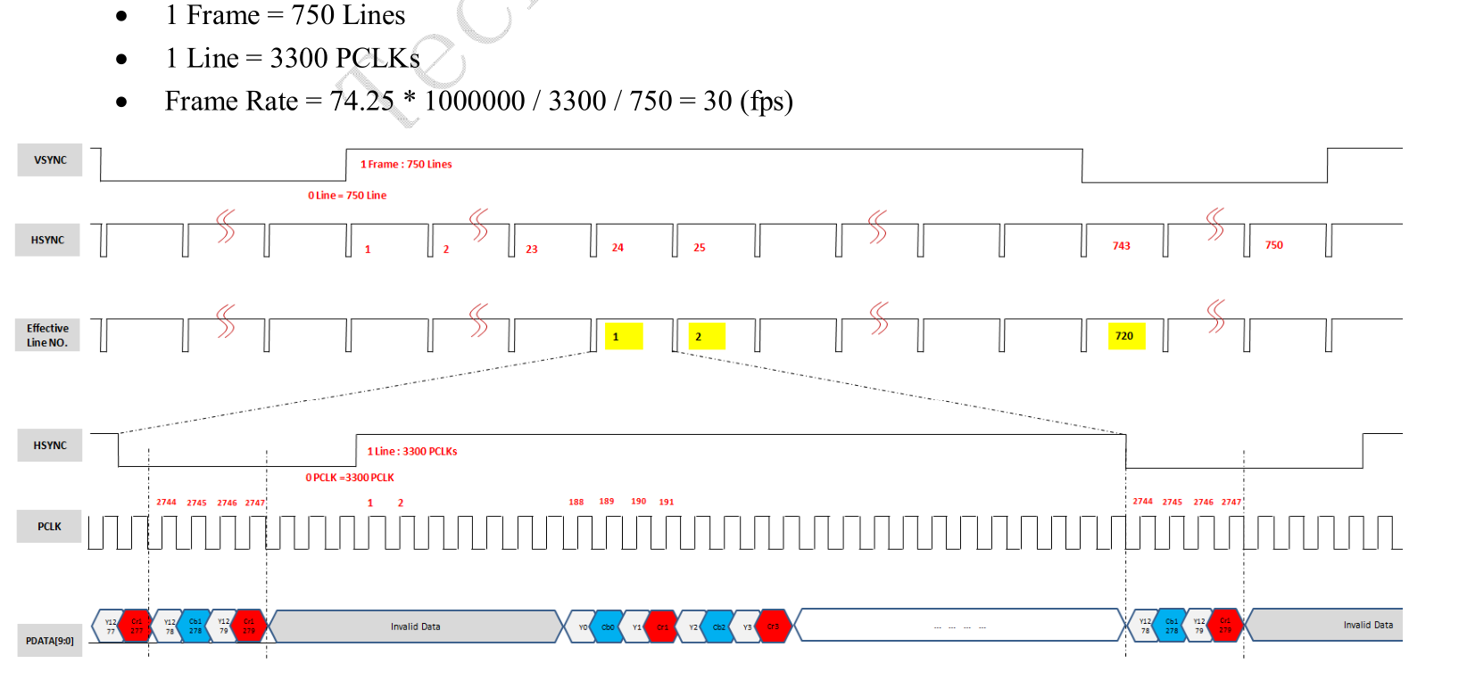

capture flow: (1280*720 )camera sensor-->ub913-->ftplinkIII-->ub934-->j6 vin2a(data0-data7)
camera parameter:
1 Frame = 750 Lines
1 Line = 3300 PCLKs
Frame Rate = 74.25 * 1000000 / 3300 / 750 = 30 (fps)
 Capture camera image:

934 driver: reference tvp5158 create a subdev
test:setup blank on 934 driver cann't solve the proble,and withotu any change.
struct v4l2_ctrl    *hblank;
struct v4l2_ctrl    *vblank;
struct v4l2_ctrl_handler ctrl_handler;
v4l2_ctrl_handler_init(handler, 1);
hblank = v4l2_ctrl_new_std(handler, NULL, V4L2_CID_HBLANK,50, 50, 1, 50);
vblank = v4l2_ctrl_new_std(handler, NULL, V4L2_CID_VBLANK,100,100,1,100);
__v4l2_ctrl_modify_range(hblank,50,50, 1,50);
__v4l2_ctrl_modify_range(vblank,100,100,1,100);
Can setup blanking solve the proble?and how to setup the blank?
If no,have any suggestion?
