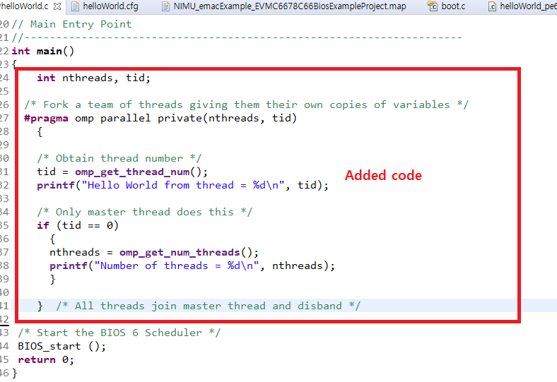

// Main Entry Point
int main()
    int nthreads, tid;
  /* Fork a team of threads giving them their own copies of variables */
  #pragma omp parallel private(nthreads, tid)
    /* Obtain thread number */
    tid = omp_get_thread_num();
    printf("Hello World from thread = %d\n", tid);
    /* Only master thread does this */
    if (tid == 0)
      nthreads = omp_get_num_threads();
      printf("Number of threads = %d\n", nthreads);
    }  /* All threads join master thread and disband */
 /* Start the BIOS 6 Scheduler */
 BIOS_start ();
 return 0;

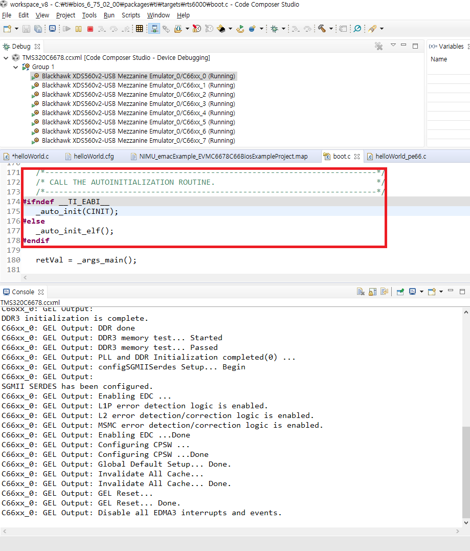

In the latest SDK, we are working on a project to use OpenMP and NDK.
However, the main() function does not enter.  as see above modifications are made.
The core runs in the function c_int00().
>> We want to use NDK and OpenMP on the latest SDK base.
    We want to combine two examples.
    However, this integration does not enter the main() function.
    How do we integrate?

    // Main Entry Point
    int main()
        int nthreads, tid;
        if (tid == 0)
     BIOS_start ();
     return 0;

    Thanks.
  • I could import your project and update the helloworld.c and .cfg file to see the failure on a C6678 EVM, will look into details with OpenMP team and update you.
    Garrett
  • Hi.
    Thanks your reply.
    I hope there is a good plan.
    You concatenated the RTSC cfg files for the OpenMP example and NDK example – this is not sufficient and can cause problems/conflicts.
    For example, when using OpenMP, Memory.defaultHeapInstance is set by the OpenMP runtime in HeapOMP.xs. However, the included config file is setting it on line 334 (from the NDK example). There are also duplicate settings for .text, .data etc.
    The thread may help your integration of OpenMP + NDK - e2e.ti.com/.../2219784 if you still observe the CCS ROV issue with the latest release and tool sets, we can continue to look into it.
    Garrett
