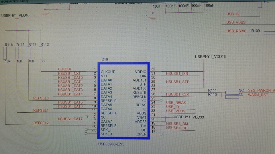

There is an issue during booting.
Sometimes HSUSB1_CLK signal will not have output signal.
Pls. refer the below schematic and waveform.
Btw, testing the delay time between sys_nreswarm and  1.8V is different with datasheet.
The time is about from 115 to 133ms. The waveform as below picture:
Green line is sys_nreswarm, and red line is 1.8V.
Pls. give some advice about these issues.

  • Luck,
    -Why can't the customer read CONTROL_STATUS register? Do the have JTAG access on the board? Do they have a debugger?
    -How many boards have they tested? How many boards are failing?
    -the scope shot you show of the clock is showing a voltage swing of only 1.5V. This indicates a power issue on the board. Have your customer check all voltage rails on the board for proper power sequencing and voltage levels.
    James

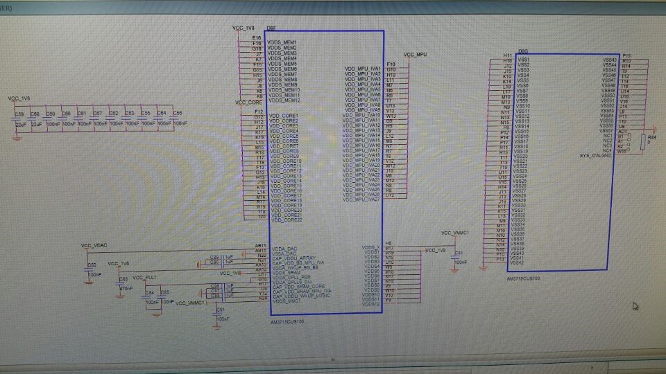

  • Dear James:
    Sorry for my delay reply, pls. refer the below information:
    Luck: There is no JTAG on Customer's board, since the boards are in MP state.
              Is there any other method to test it?
    Luck:They have tested 80pcs boards, and there are 33pcs boars failling.
    Luck:pls. refer the below pictures:
    Pls. give some advice about it.
  • Luck, have they ruled out an assembly issue on the non-working boards?  Can they try to perform a processor swap (move a good processor to a bad board, and move a bad processor to a good board).  Or simply put a new processor device on a bad board.
    They also need to check the voltage rails you show to ensure proper voltage on all the rails.
    james
  • Hi James:
    Pls. refer the below information:
    Luck: Yes, the customer performed the processor swap which is putting a new processor device on bad board.
              And found only parts of the bad boards are OK, and there are some boards are bad.
    Luck:Customer confirmed they use PMIC and the voltages are ok.
    BTW, before you concerned about the below issue:
    I have a question, and how is the voltage level  of the requirement? since customer compared bad board and good board the voltages all about 1.5V.
    Pls. kindly help give some advice about it.
  • Luck, i'm confused by your response.  When they put the new processor on the bad board, did the board work or not?
    Technically, Voh is 1.35V, so the high voltage on the clock is technically within a valid range, but that's just one measurement on one board.  The voltage may be worse on other boards.  Regardless, 1.5V still indicates a possible problem.  The high voltage should be closer to 1.8V.
