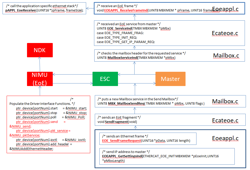

  • Martin,
    Essentially you need to replace the EMAC driver functions (NIMU_send, NIMU_pktService) associated with NIMU/NDK to the EoE functions from EtherCAT(EOE_SendFrameRequest, EOEAPPL_ReceiveFrameInd), similar as NIMU_ICSS_send and NIMU_ICSS_pktService for ICSS EMAC.
    I tried to illustrate the EoE/Mailbox call flow as below, hope this helps.
    Please refer to the Network Developer's Kit (NDK) Support Package Ethernet Driver document for details of NIMU layer, also the EMAC driver/NIMU/NDK structure from the PDK packages\ti\transport\ndk\nimu\src\v4\cpsw_nimu_eth.c
    With the NIMU driver update, the BSD socket APIs can be used as is.
    Garrett
  • Thanks Garret, it is very useful!
  • Hi Garret,
    thank you very much. The document and your illistration were the missing parts for understanding correctly.
